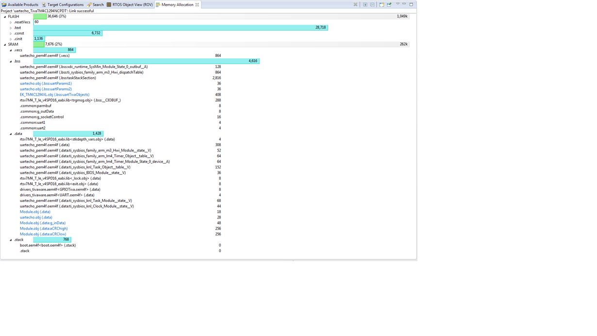

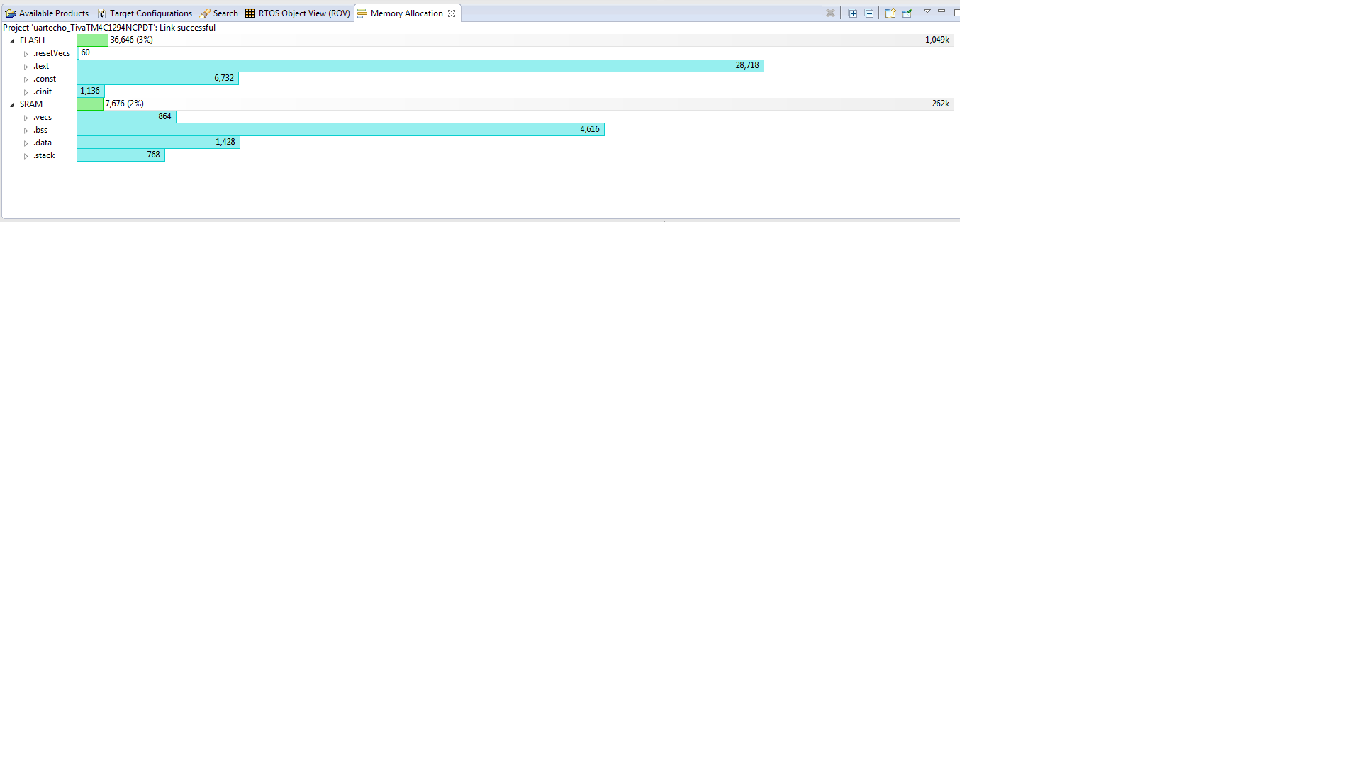

    I am using the default stack and heap size in RTOS uartecho example in Properties->Build->Linker->Basic Options (in CCS 6.0.1), which is 512 and 0 . I changed both stack and heap size once to 1024, the second time to 2048 and the third time to 0x8000, and it looks like the average time to crash increases, but it still happens. And it can still happen very fast in some trials, say after 30 printouts.
    Also, in file uartecho.cfg, there is another stack and heap that I have not touched yet. Here are the parameters:

  • Looks like the stackpeak is the same as stacksize for task "ti.sysbios.knl.Task.IdleTask". The address of this taks, i.e., 0x200018e8 is exactly where the task overflow occurs.
    It looks like the "echo" task is overwriting the stack of the ti.sysbios.knl.Task.IdleTask.
    The idle task is in the TI-RTOS function readData() writing to object->readBuf when it overwrites the stack for ti.sysbios.knl.Task.IdleTask.
    I think the problem is the the buffer[0..size] array passed to the UART_read() or UART_readPolling() functions from the echo task overlaps the stack for the ti.sysbios.knl.Task.IdleTask. How is the buffer array allocated?
