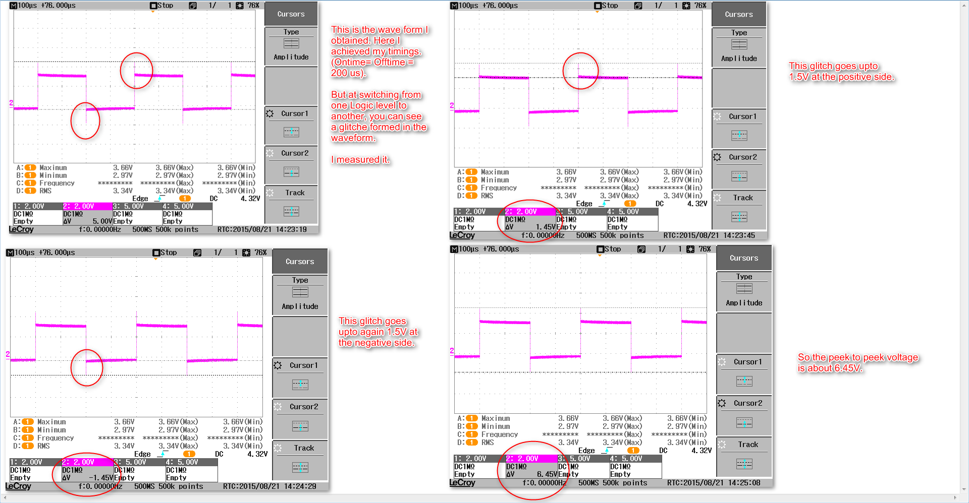

I am using TMS570LC4357. Here I am having a problem with Toggling a HET Pin or GIO Pin to produce a PWM Signal.
I tried with both GIO Pin and HET Pin. I want a waveform of Ontime = Offtime = 200 us.
I produced the waveform using HET and also with GIO Pin. In both tries, I can achieve the Timings. No issues with timings.
But my problem is the Voltage.
Please have a look at the following scope shots.

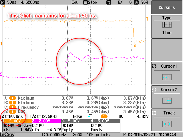

So this 80 ns glitch actually pollutes my actuator to toggle a signal.
I want to know why this is happening?
rise, fall time are less than 12.5 ns as per the data sheet of TMS570LC4357.
But 80 ns is considerably long time as for as my project is concern.
(Sometimes this time duration comes more than 40 us/ 50 us.)
