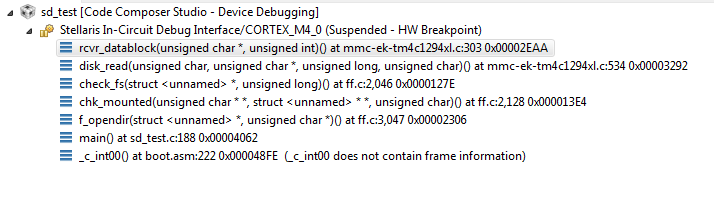

  • Here is some more information on the issue. I discovered something extremely peculiar that I can't quite put my finger on. Here is the stack at the location of the error:
    The code in rcvr_datablock() is
    /* Receive a data packet from MMC                                        */
    static
    BOOL rcvr_datablock (
        BYTE *buff,            /* Data buffer to store received data */
        UINT btr            /* Byte count (must be even number) */
        BYTE token;
        Timer1 = 100;
        do {                            /* Wait for data packet in timeout of 100ms */
            token = rcvr_spi();
        } while ((token == 0xFF) && Timer1);
        if(token != 0xFE) return FALSE;    /* If not valid data token, retutn with error */
        do {                            /* Receive the data block into buffer */
            rcvr_spi_m(buff++);
            rcvr_spi_m(buff++);
        } while (btr -= 2);
        rcvr_spi();                        /* Discard CRC */
        rcvr_spi();
        return TRUE;                    /* Return with success */
    In the second do loop, btr starts at 512. Once it gets down to 16, rcvr_spi_m() is called and succesfully executes. Once it exits the method, my program jumps to line 237 in the same file (it is always this line) in the middle of the power_on() method and the FaultISR gets triggered. The NVIC_FAULT_STAT has the NVIC_FAULT_STAT_INVSTAT flag raised. The NVIC_FAULT_ADDR is 0xE000EDF8.
    What could cause my code to jump to a seemingly random line?
  • Hello Daniel,
    Could it be a stack overflow? Did you increase the size of the stack and also check with the existing code how the stack pointer progresses over time?
    Amit
  • Amit,
    I set a hardware watchpoint to '__stack' and it did not trigger. I increased the stack size anyway and that did not solve the problem.
    Dan
  • Amit,
    My apologies. Although I modified the stack size at first the change did not seem to stick the first time around. Increasing the stack size from 512 to 1024 did solve the problem and I am now able to reliably communicate with both of my SD cards. Thank you so much!
    Dan
  • Hello Dan,
    My worry is that over a longer period of time the stack would cross 1024. You would need to see why SP is getting PUSH-ed more than POP-ed
    Amit
  • Amit Ashara said:
    You would need to see why SP is getting PUSH-ed more than POP-ed.
    Bravo Amit, while poster (seems) satisfied - a weakness appears to have been noted - and even a "higher wall" may not deflect all attackers...
  • Amit,
    Excellent point, I will look into the issue.
    Dan
  • Hello Daniel,
    Thank you for following up on the same. Thanks cb1 for emphasizing the point
    Amit
