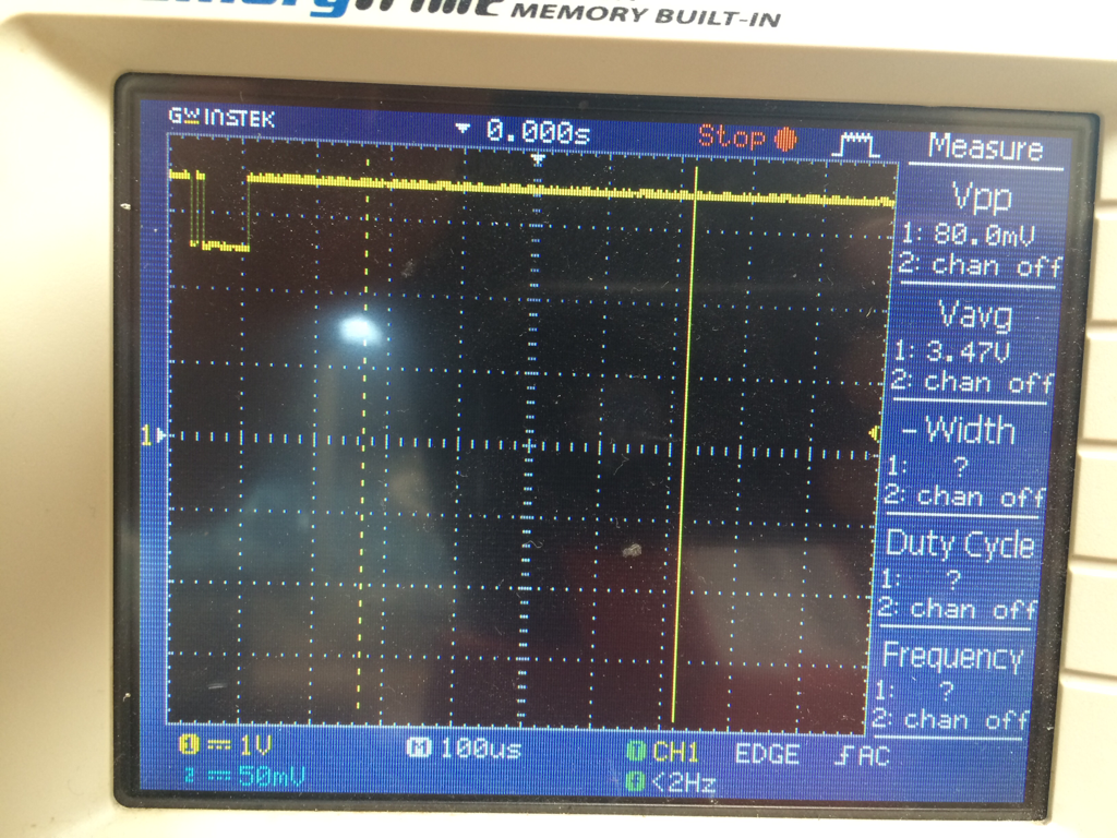

  •  Hi Amit,
    So I added the unlock code and now I see something coming out on D7, which is great. However, when I attached my oscilloscope (I still can't get anything to show up on the logic analyzer, unfortunately) I can see the pulses but they're not dropping down to ground. The signal drops down from 3.3V to about 2.5 volts, instead of dropping down to ground. Do you know why this might be?
    Here is a picture: http://www.imgur.com/QmJCUE5
  • Hello Zero_PD,
    Can you configure the IO in GPIO mode and toggle it in the code to see if it swings the full range of 3.3V to 0V?
    Amit

  • Thanks Amit and CB1. Before I got deep in the trencehs, I tried something I should have done right away. I disconnected D7 from my circuit and put the scope directly on the microcomputer pin. Of course, it looked perfect then, with the pulses dropping to 0V. I then connected my logic analyzer. Everything was perfect. 0xAA, 0x00, 0x3C, exactly the data bytes that were supposed to be going to the bno055.
    I dug around a lot more and it turned out - and this is a little confusing because of the breakout board - I had TX and RX flipped. Flipped that around and all is right with the world! For now.
  • Thus appears that (both) the future & RX/TX were not evenly (nor properly) distributed...
