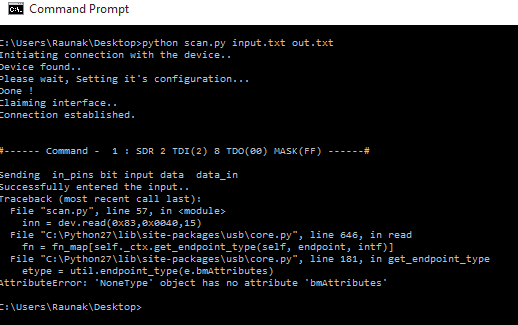

I am trying to send data to TIVA C (TM4C123GH6PM) usb stick using the python library PyUSB. The code I am using is the following:

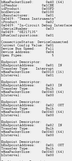

input.txt file is in the format : SDR 2 TDI(2) 8 TDO(00) MASK(FF)
dev.write is working but dev.read is not working.End point address in dev.write I am taking is 0x02 which should not work ar it is out epaddress and dev.read is giving above error whatever epaddress I use. Also why there is no bEndpoint address of out of interrupt type ep (there exists only in epaddress 0x81 ).
