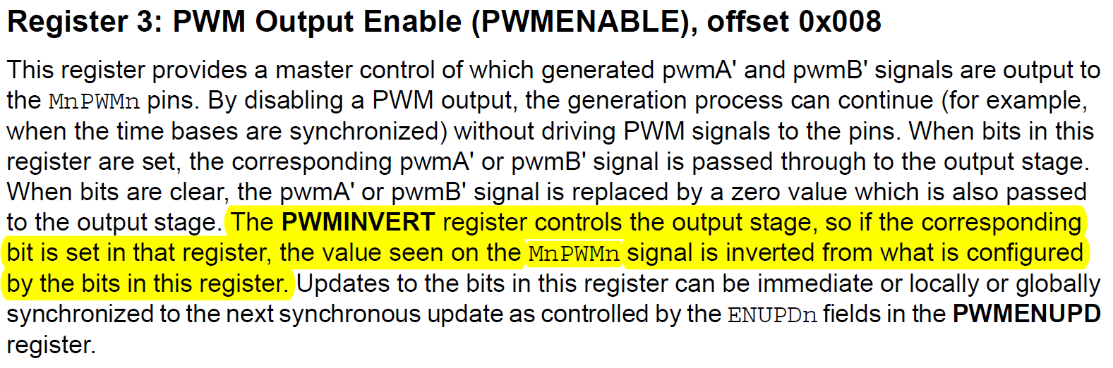

  • Thanks for the offerings guys. We are still a bit confused as to why a pulse width of 0 seems to work fine, but inverting it does not. However, I stumbled on a little trick in the datasheet that fixed our problem without having to resort to GP output toggling, which would have no doubt had its own headaches.
    What we have implemented today is to leave the pins configured as PWM, but leave them disabled (PWMOutputState = false), which will still output a logic level signal at the respective pin. Then, we can toggle this value to be either a logic low (default) or logic high (using the PWMOutputInvert API function), effectively gaining 0% and 100%. The huge benefit for us is that we maintain our synchronization between channels, which may not have been possible had we toggled to GPIO (not to mention it makes the code cleaner).
    The code has been running successfully all day here, and so unless something unforeseen happens, I'm considering this closed!

  • cb1,
    While it is always nice to get vendor feedback, I think for this application it is not needed. This use is not "outside of normal" or (unusual) as you imply. In fact, it is taken directly from the datasheet:
    We have verified in our application that we see the appropriate logic signal at the output in both conditions, in line with the datasheet.
