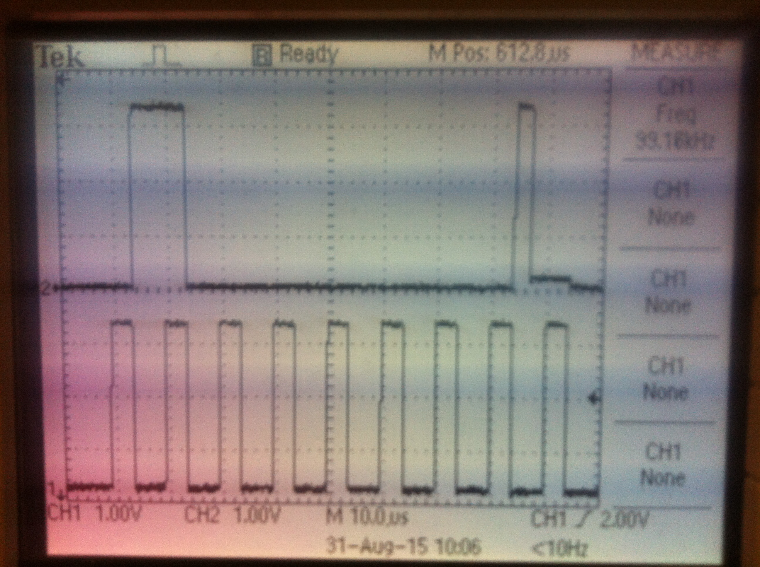

I am working on detecting fail bits from I2C expander, and there is only one Master which is MCU.
I thought it worked well since I could read the right values(4 bytes) from the expander. However, it suddenly stops working after running 2~3 hours.(both SDA and SCL go high).
The task,I2CTask in my project, is executed in a regular time basis and read values.

    The I2C expander resides on another pcb that connects to the custom MCU through the header(8x2), and there are no connection problems.
    Also, the expander runs at 100 kbps and both SDA and SCL are within around 3.3v and acceptable noise/glitch
    Sorry I don't have a proper size of USB flash or cable now. the above wave form describes SDA/SCL of bank 4(3rd bytes from expander)
    The reason why I think of changing from polling to interrupts mode is that other tasks with different priority/schedule run concurrently with I2C task(now set up for the lowest priority) and if I2CMasterBusy() takes too long to detect of transmission complete sometimes then it might cause problems.
    Right now the expander on the separate from MCU board does not have a reset connected with MCU. Eventually it will be connected with MCU but right now I am focusing on what caused this issue.

  • Hello Jin,
    When the IO expander stops responding (SDA and SCL going High), what does the next I2C Frame on the scope show? I am trying to check Time Event Failure + 1 to see what went wrong at the Failure Time Event. Also the acceptable glitch may not be acceptable to the I2C Master Controller. Did you try and use the Glitch Filter to see if the issue happens?

  • Hi Amit,
    I have not applied "Glitch Filter" and I don't know what it does now. What I did about glitch was kept monitoring SDA/SCL using scopes to see if glitches took place, and I did not see any glitches.
    Sorry about my unclear explanation of "acceptable glitch"
    Jin
  • Hello Jin,
    A glitch may be few 10's of ns wide during 2-3 hrs of testing, I doubt visual check on scope will show that (unless the scope is configured to catch such an event). I would still advise, to use the glitch filter and then we can see what is the effect of the same. Also my RFI for what happens on the next to the failing I2C Frame request, remains unanswered!!!!
    Amit
  • Hi Amit,
    I think you are talking about the below codes for "glitch filter", so I added it on I2C set up function.
       // 8.33ns at 120Hz
       // for the standard mode(100kbps), glitch suppression of 50nsec woulbe be
       // 6 clocks --> chose 8
       ROM_I2CMasterGlitchFilterConfigSet(I2C5_BASE,I2C_MASTER_GLITCH_FILTER_8);
    Jin
  • Hello Jin,
    Yes, that is correct function to use for TM4C129. Do make sure that after using the same the Register for Glitch Filter shows the correct setting.
