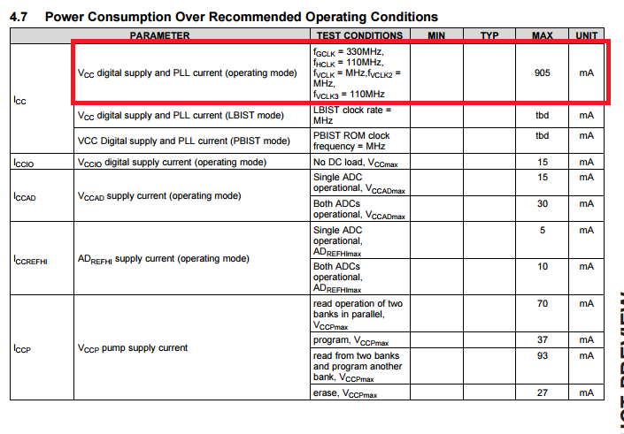

Good day I have a big question, I would like to know what the overall consumption of a Hercules RM57L and RM46 and RM42?
Datasheet indicated in 905mA to RM57Lx, this is almost 1 Ampere of current; this is real or referential.
Best Regards

  • Martin,
    It's a real spec number, but not  (EDIT) note that it is a max over the recommended operating conditions.
    So that would be the max operating temp, max operating voltage, and a unit that is 'hot'.
    You probably won't easily reproduce this in your own testing, but you should design for it.
    -Anthony

  • Hi Martin,
    Yes, the device includes various low power modes but they are based on shutting off clocks.   This will cut down the power consumption due to switching, but there is another component called leakage that at the 65nm node is significant.   The RM57L datasheet is still product preview and is missing some of the data that is in other datasheets.  But look at the RM48 datasheet, and you can see the typical power consumption is listed at 260mA and max at 420mA -- at 220MHz.   There is an equation in the footnote that shows the effects of voltage, temp, and frequency on this number.
    If you take footnote 2, it says that in the maximum power consumption case, the 420mA number could be derated by 1mA/MHz with frequency.    So if you were to shut off all the clocks you may expect the current consuption to drop by 220mA.   That still leaves up to 200mA max due to leakage.  There's also equations in the footnote where you can plug in voltage and temp and further derate.    But it's going to be some # of mA,  not uA.
    -Anthony
