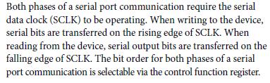

    Staff/I have checked our most recent DDS device, "AD9858" 1GHz clocked & able to generate a:  "frequency-agile, analog output, sine wave at up to 400MHz."  (note: cb1 expects to be featured by this vendor w/in coming months...)
    Pertinent info - directly from that device's data sheet "agrees" with our (earlier) supposition:  (i.e. real maker would not "blow" the SPI spec)
    You will (readily) note that - as we surmised - MSB "leads" the bit parade!   (nothing new there...)
    And (just prior) to this (detailed, MSB first) chart appeared:
    Note that last sentence - this particular device is so well thought/conceived that even the bit order - may be changed.   (and for both phases!)
    We remain in doubt as to any "real device" mandating a lsb first order via SPI...  (perhaps you/group "misread")

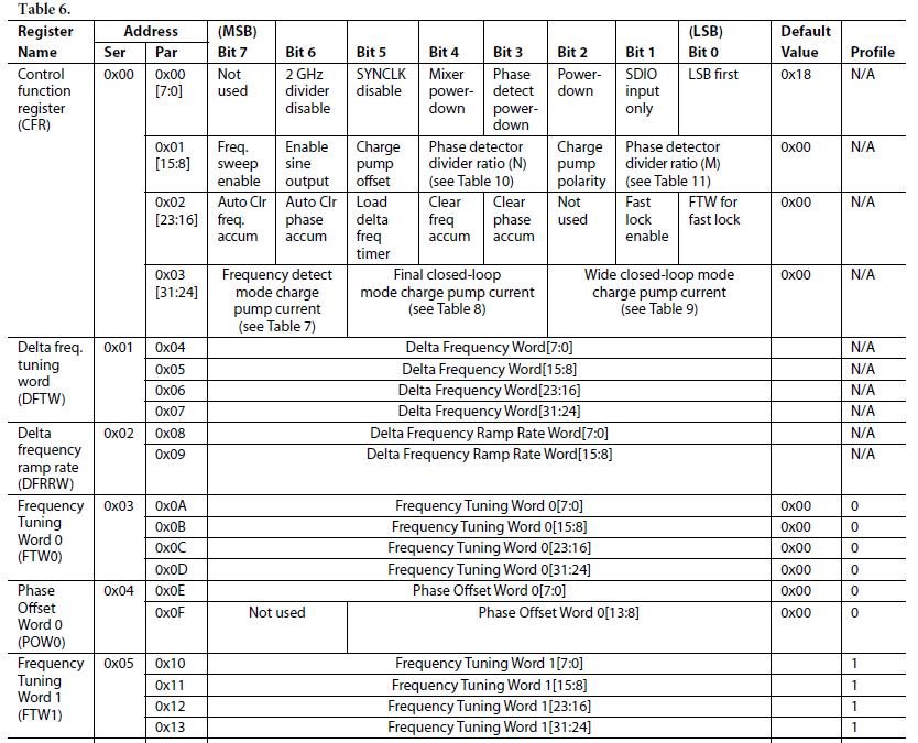

  • Hi cb1_mobile,
    I didn't mention it's an SPI, maybe I should've emphasized more on that, sorry.
    it's a synchronous serial, that's why we are using SSI module to interface it.
    here is the link
    Thanks.
