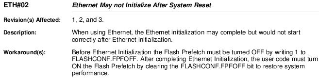

  • Not sure if the following errata could cause a failure for the link to fail to be established with some external devices:
    Has the work-around for ETH#02 been implemented?
    If you are using the TI-RTOS Ethernet driver, http://processors.wiki.ti.com/index.php/TI-RTOS_TM4C129_Emac_Issues describes where to check for the work-around being applied.

  • Hello, Amit!
    We have fixed in our software the ETH#02 error, which is described in ERRATA. After we done this, some devices started to work properly.
    But the error isn't still solved completely.
