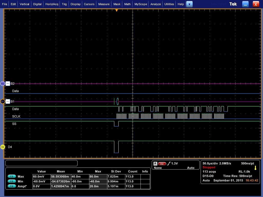

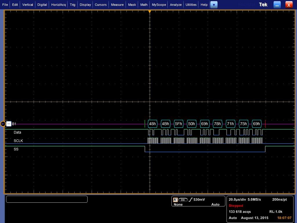

I'm implementing a SPI communication with the microcontroller TM4C123GH6PZ, but the chip select signalsI am driving through GPIO independently.
So far performed correctly I am sending as shown in the picture
However, to reprogram for sending other bytes, the chip select not operate in the same way and instructions appear to be performed sequentially. That is, it goes high before the bytes are sent as shown in fig.
Does anyone have any idea what happens?

    3. Does the transaction fail, after one attempt, i.e. it works once and then it does not work again?

    3. The program worked well, sending information performed as shown in the first image. Make a change to the characters sent by the microcontroller and the problem is present and has not returned to work properly.
