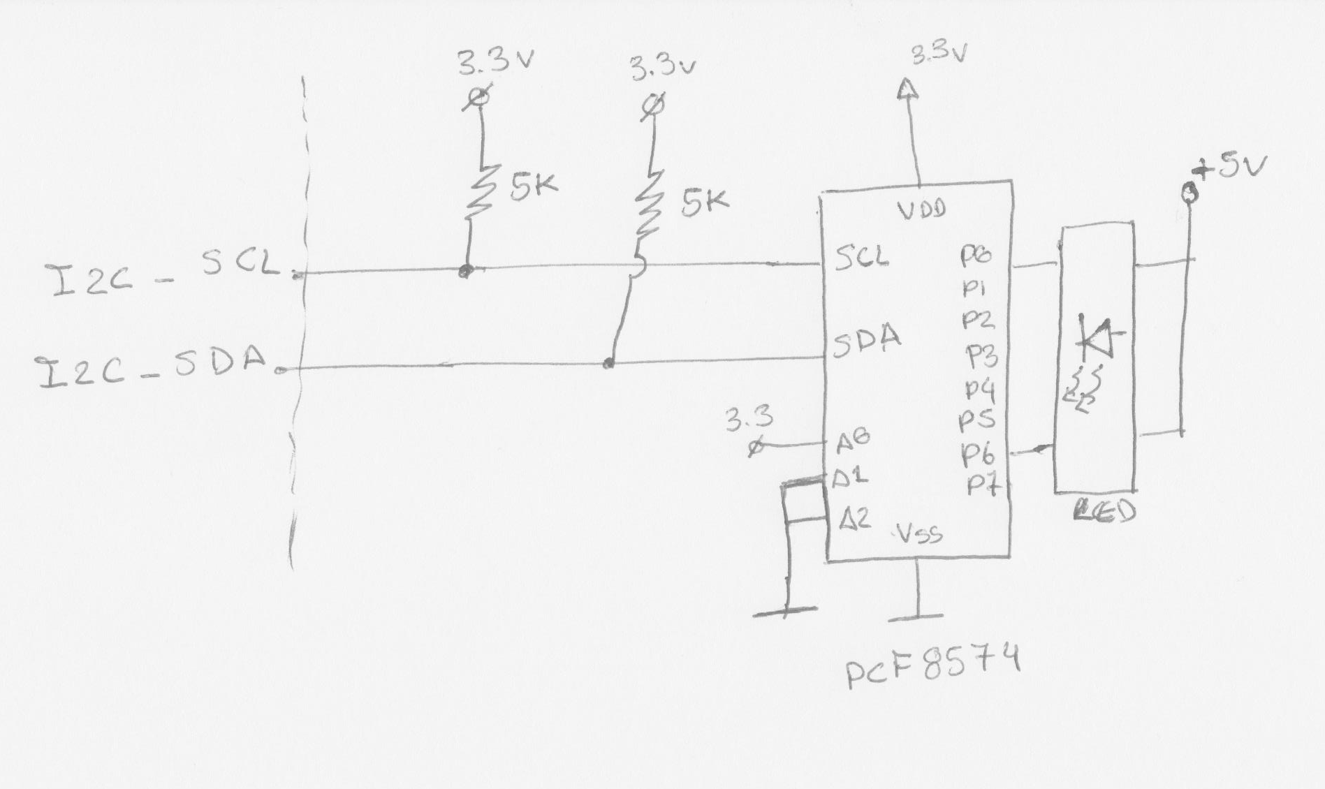

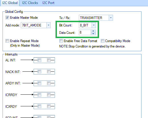

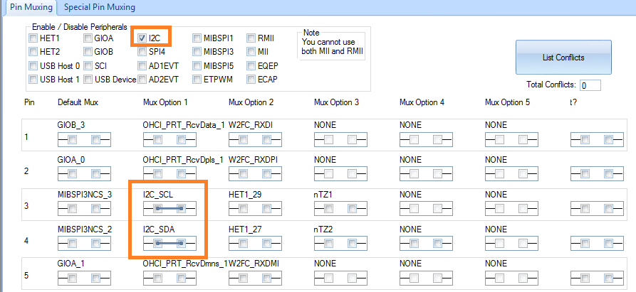

for the sake of learning, trying to implement an I2C communication between Hercules LP RM46 and  PCF8574 (NXP) in write-only mode; I'm using the following settings:
PINMUX configuration in HalCoGen
in the global settings, I have bit count and count data; I read the manual but could not understand the use of "data Count"
Hercules and PCF8574
Hardware configuration in my pull-up resistors have 5KOhm , I have doubts whether it is necessary to apply the pull-up resistors in HalCoGen?
the code to write to the PCF8574 is:
#define PORT_BASE_ADDRESS 0x42
void Write_PCF(unsigned char data_byte)
    i2c_start();
    i2c_write(PORT_BASE_ADDRESS);
    i2c_write(data_byte);
    i2c_stop();
It's pretty simple, but do not know the right way to send the data using the functions provided by HalCoGen !!
