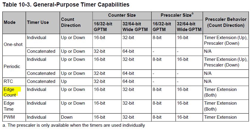

    May I note that your request - quoted above - rises above the goal of "KISS?"   Kindly look here:
    The highlighted "Edge Count" seems best for your objective - don't you agree?   You ask about adding the complexity of interrupts - yet might it make more sense to feed your (selected) Edge Count configured, Timer input - with a low frequency test signal, initially?   I'd suspect that the timer would perform as a counter - and not require the complexity & demands enforced by interrupts - at least in your early, investigative stage.
    You may further simplify your study by using a free MCU GPIO to provide a "known" number of pulses into your timer - and then simply reading the appropriate timer register - to confirm that the count is proceeding as expected.
    Once you've mastered this (simpler) method - we can continue into interrupt - but too often the (early) introduction of interrupts confounds - we find it far more productive to follow KISS - one small battle - yielding one small solution - at a time...   Are we in agreement?

    now i'm working following your instructions to KeepItSimple, the only think i don't understand is, how to connect the generator with the timer counter, the question is: have i to connect the output pin with a jumper with the input pin of the counter, or there is a better/simple way to do it?
    Yes, we are in agreement
