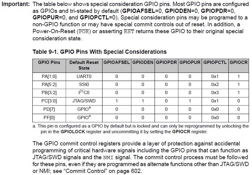

  • BP101 said:
    Port C  due to the JTAG pins C0-C3 are all locked GPIO pins, seemingly GPIO port C4, C5 need be unlocked using mask key code ( |= 0x30).
    Perhaps you did not unlock the GPIO port C prior to configuring it as UART7?
    My friend - Port "C" GPIO pins outside of PC0-PC3 require NO SUCH Unlocking!   Here - the MCU manual details:
    Port "A" comes closest to your "seemingly" - but PA6 & PA7 escape - thus NO Port requires a complete Unlock!  We've (long) used "upper nibble" of Port C - never unlocking!
    Devil in such detail - MCU manual provides much...
  • >seemingly GPIO port C4, C5
    Did use the word seemingly. Albeit long ago CB1 (seemingly) agreed port C unlock (may) be needed for COMP0(C0-/C1-) input assigned GPIO pins C4,C7. To answer BP101 post "Why PinMux tool can not program comparator pins?"
     Tiva Pinmux Tool output file wrote unlock C code for GPIO port C pins C4, C7. That unlock code led to belief the (entire) GPIO C port was indeed locked and Table 9-1 was incorrect. Appears was not alone in that belief to unlock the upper nibble GPIO port C pin [4:7].
    I'd love to see that (long past) "agreement - I'm in doubt.   Much doubt!
    It is only Port pins C0-C3 which are now (and have been) so encumbered!
    Good luck.
  • Agree it seems that would be the case C0-C3.
    Bottom of page last post I do suggest the CR register protects lower bits leaving the upper nibble unprotected safe to write. One post above that CB1 corrected to use (|=) but if the lower nibble is locked who cares. Suppose the confusion stems from past PMT added unlock CR prior to configuring C4, C7. Seemed like good idea at the time.
