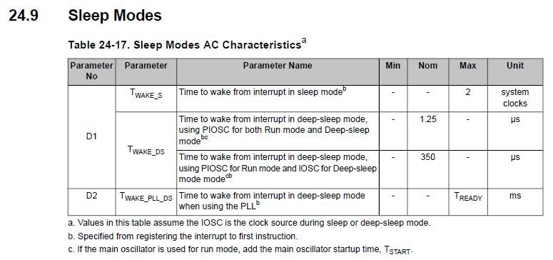

    At least to me - it's unclear if you've seen the following:   (this from our LX4F MCU manual)
    Thus - when in "deep sleep" it appears that (well less) than 1mS (chart shows 350µS as typ.) is your desired "wake up" time.   I'd ask if you (really) have the (typical) 32KHz (external) xtal installed?
    MCU manual shows (poor) power savings when in "sleep" mode - greatly improved when in "deep sleep."
    Your listing of ~30mS to "wake" may deserve some explanation - I can't see it from good, several minutes read/review of manual...   Indeed if using the "main oscillator" (see the "c" listing, above) you incur the potential (max) wake "penalty" of 18mS, additional - that's dreadful...   [edit]  Note: it appears this 18mS may be avoided by running under PIOSC and internal ~30KHz oscillator - it is (my belief) primarily caused by the external xtal.

    That said - let's NOT (yet) "drink that 350µS wake-time" Kool-Aid!   Why's that - look carefully at "c" - at the base of the timing chart.
    "If" using the master oscillator - it appears that a "penalty" of (up to) 18mS is extracted!   (I added that to my post as you were composing your response)   That's horrendous - I don't believe that same (significant) time penalty lands @ other ARM MCUs...   You may wish to "clarify" the full meaning of "master oscillator" - to see how damning this may be...
    [edit 23:48] Upon my 3rd read - it now appears that this ~18mS (max) time penalty is only inflicted when an external xtal is employed with the main oscillator.   Thus - if you "run" w/PIOSC and w/MCU's "internal" (very roughly) 30KHZ oscillator - you AVOID that horrendous time penalty!   And - in fairness to this vendor - that time loss is primarily caused by the external xtal - not an MCU weakness!

  • Hello cb1,
    The 18ms penalty when using external oscillator is correct. However there are other ways of getting to 18ms based on the LDO setting in deep sleep and the clock divider in deep sleep, it is possible to get the same time with the internal oscillator as well.

    So Table 24-24. seems to give further clarification. So how I think I was using it would mean a 19ms delay to wake up (run mode = 80Mhz with PLL and Deep Sleep = external crystal) - right?
    So let's analyze this. Apparently Energia already configures some stuff (hidden startup configs is why I usually don't use Energia mixed with Tivaware).
    Energia sets the LDO voltage to 1,0V instead of the max 1,2V, the Ram and Flash to low power mode and actually sets the low power mode to use the PIOSC with 16x division (1Mhz).
    So with this I should expect, according to the table 145.64us wake up time.

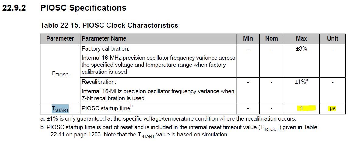

  • T(start) is listed for our past LX4F - I saw that last night! (look again - search on Tstart)
  • Hello Luis,
    The Table does not have the main oscillator start up time due to variations in startup time from crystal manufacturer to another.
    Amit
  • Hello (both) Amit & Luis,
    May I note that the equivalent of our past LX4F (TM4C123AH) does include Tstart.   (see below)
    We note that (any) external xtal is avoided via use of the PIOSC - thus "blame" cast toward xtal maker seems misplaced.   Multiple other MCUs are able to "wake" far faster than the 18mS - thus far - reported here.
