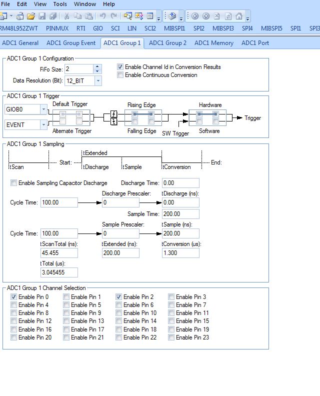

I'm using the RM48l952ZWT on the TMDSRM48HDK dev board.
I'm connecting 2 sensors to ADC1 channel 0 and 1 (or channel 0 and 2) and i'm using the following instruction to read the converted data:
adcData_t adc_data[2];
adcStartConversion(ADC1,adcGROUP1);
gioSetBit(gioPORTB, 0, 1);      /* Trigger ADC1 */
while((adcIsConversionComplete(adcREG1,adcGROUP1))==0);
adcGetData(adcREG1, adcGROUP1,&adc_data_front[0]);
I'm using the following settings in HalCogen:
Everything work fine for Channel 0, The value I read is what i'm excepting. The problem is Channel 2 reading is very much influenced by Channel 0, they are not identical, but for example if Sensor 1 (connected to channel 0) output value is 0 and Sensor 2 (connected to channel 2) output value is 0 I read correctly 0 and 0 in the converted data. But if Sensor 1 output converted reading is 1200 and Sensor 2 should be 0, I read in channel 2 a value of around 1000, and the higher is the reading of Channel 0, the higher is the leaking on Channel 2.
Do I have to handle some others setting in HalcoGen in order to avoid this problem?
Thanks again
Giorgio
  • Hi Giorgio,
    I don't know how you connect the sensors to ADC1 input pins on J9. Can you please test your code using channel 8 and channel 9 of ADC1? Those two channels are used for thermal (AIN8) sensor and light sensor (AIN9) on board. The sensors are located between the two connectors for DCAN (J2, J3).
    QJ
  • Hi QJ,
    Thank you for your message.
    As you suggested Channel 8 and 9 are working properly.
    I have also discovery that the leaking was my fault, as, I don't why, I was connecting the ground pin of the sensor back to the ground pin of the board and for some reason it gives some problem and the other issue was that I was testing sensor 1 when sensor 2 was not powered, now that they are both powered, the problem is not there anymore and the converted reading are correct.
    Thanks again for your help
    Giorgio
