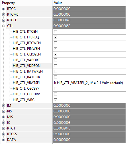

    I put the changes with no effect. It looks like something is still holding micro to hibernate. In trace window i can see that in HIBCTRL register PINWEN bit is on, CLK32EN is on, WRC is on, and HIB_REQ bit is also on. Micro is in while loop so i can see that systick is still working, and micro is responding for externa interupts like gpio.

    Can you please send a snasphot of the Hibernate Registers? Also is this the LaunchPad you are using or a custom board. if a custom board please send a snapshot of the board. If the LaunchPad note that VDD3ON bit has to be set.

  •  VDD3ON bit should be set also before the Hib request or its setup automaticaly by some of API function?I'm using custom board. HIB pin is not used (floating), Wake is connected to button. VBAT pin of micro is connected to BATTERY. I'm using 16MHz xtal and 32.784KHz oscil.

    Thanks for the data and information
    1. WAKEn pin must be connected to a Pull Up resistor to VBAT supply
    2. If HIB pin is not being used to control the LDO that powers VDDS and VDDA supply rail then VDD3ON must be set in the HIBCTL registers by explicitly configuring the register bit
    Amit
