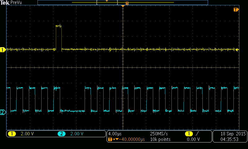

  • Thank you for your advice. From using the scope we determined that the CSn was not properly being pulled low/high. It did not need a register offset and it has been corrected to: "GPIOPinWrite(GPIO_PORTP_BASE,GPIO_PIN_5,0x20);" to pull high and "GPIOPinWrite(GPIO_PORTP_BASE,GPIO_PIN_5,0x00);" to pull low.

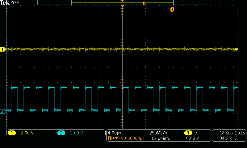

    The following images are from the oscilloscope, taken while the  cc1101Write function was in a continuous loop. The results are representative of what we observed while the program was ongoing. The clock signal (SCLK) is in blue for reference. We observe from these that the CSn is correctly being pulled high and then low again (Figure 1), that the MISO pin is alternating from 0 to 1 every 4 clock ticks (Figure 2), and that the MOSI pin does nothing (Figure 3). We are unsure what to do with this information.
    Figure 1: CSn signal in yellow, clock signal in blue
    Figure 2: MISO signal in yellow, clock signal in blue
    Figure 3: MOSI in yellow, clock signal in blue
  • It is normal in such cases to:
    a) determine that your "dead" MOSI pin is not shorted to ground (or adjacent pin) or is otherwise connected/burdened
    b) after (a) switch that pin into GPIO push-pull output and toggle. Does that yield a measureable output?
    It is possible that your remote device - connected to the MOSI pin of your MCU - is the culprit, too. Also - your ground between that remote IC and the MCU must be solid - and common between each...

  • Hello cb1-
    But the poster on the waveform plot shows that the MISO is toggling well between 0V and 3.3V. Then how come it is not measurable?
    Amit
    Indeed it does - yet that "action" is coming from the Slave device - is it not?
    The MCU (aka Master) sits "silent" (w/out output) - and we're not told of its (past) "adventures..."
  • Hello cb1
    Right you are. It would be a good idea to disconnect the CC110L from the EM adapter to isolate the SSI for any monitoring
    Amit
