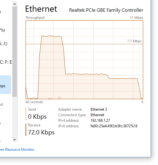

I am using the launchpad to prototype a UDP based real time data monitoring system.
The launchpad is being fed with 16 bytes through the SSI0 interface every 100 microseconds. SSI is running at speed of 7.5MHz clock.
SSI0 generates an interrupt upon receiving the data and it sets a status flag =1.
Once ISR is finished, the main while loop has a if statement that checks if status ==1 and then proceeds to send the udp packet consisting of data received on the SSI0 interface.

The problem I am facing is, once the microcontroller resets, the UDP stream is perfectly running at ~8Mbps but suddenly after sometime there is a drop in throughput. At some point it completely stops the transmission but after 4 - 5 seconds it again starts pumping at ~3-4Mbps.
The following screenshot should make the problem more clearly visible.
So, I am trying to figure out what is causing this. I expect it to transmit data in real time using whatever bandwidth it requires.
If it is necessary, I will post some more of the relevant code.

  • As lame as it may sound, I found the problem to be with the SSIDataGet. In debug mode, I found out whenever there was sudden drop in throughput, controller was halting completely at SSIDataGet function. So, I replaced it with SSIDataGetNonBlocking and everything is working fine. I will monitor the performance thoroughly to see if there are any further problems and contact you if I find any.
    Thanks for your support :)

  • I would let the program run normally and monitor the ethernet throughput on task manager. Whenever I saw the data rate dip to 0Mbps I would pause the program and see the status in debug window. There I saw the program being stuck at SSIDataGet.
    The interrupt is generated on RXFF which according to my understanding is generated only after data has been placed in FIFO. So I do not understand why the program stops at SSIDataGet.
  • Hello Salil,
    The SSIRXFF means that the RXFIFO is full. In such a case the CPU must read only the number of bytes that the FIFO can hold. E.g. it should read out 8 bytes only. If the loop on the other hands try to read more than 8 on RXFF interrupt it must wait for the FIFO to have some data.
