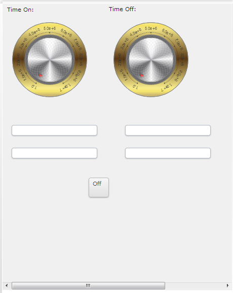

The GUI to accompany this code contains dials and text boxes that are bound to certain values that set the delay time for the lights. (It is similar to the CCS example "Blinky"
My next task is to create a button that turns the light off altogether. Essentially a power button for the GUI.

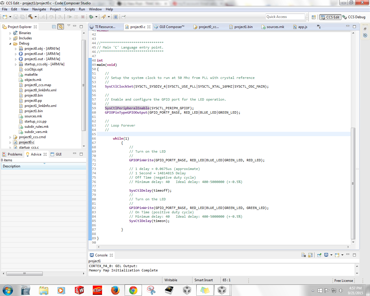

Main Code:

    That's why I was curious to see if there was a way to tie a function in the main code to a button in the GUI Composer
    I don't quite understand how the buttons in CCS work in general. When I click on the button, what is it calling? The app.js?

    Sorry I should have been more clear with my terminology.
    I mean a button control.
    Created in the GUI Composer
    When I create a button and put it in my GUI and then click it while running the program, what is it calling.
    I will attach a snapshot momentarily to the original post
  • Hopefully this better illustrates my question
    What is happening from the time I click on the button in my program to the time an action occurs because of it.
    For example, in visual studios, when you have a button in your program, a specific on click function is created automatically for that button.
    Then you can write your code in that function so that when the button is clicked a task is performed.
    Greatly Appreciated
    -Brian
