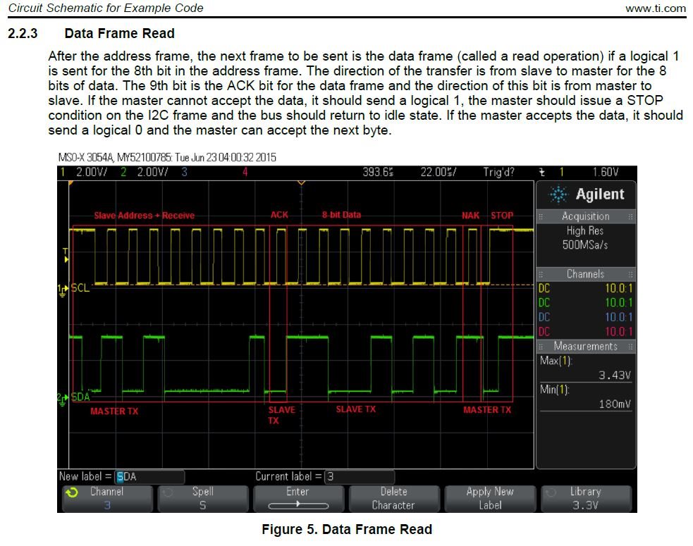

I write new screen for attached file(Extern EEPROM: Onsemi EEPROM)
1. What is the use of Quick Command Here?
=> I just test Quick command code. The result is same without Quick command code.
      I will delete this code.
2. The Read data pattern does not seem to match what normally a I2C memory read would look like. Can you check the I2C SRAM Memory data sheet on the sequence to read data locations?
  => I used Extern EEPROM that made in Onsemi EEPROM(CAT24C512)
       and SRAMTest data is just randomly test data. I want to freedom to read and write using the I2C interface in Extern EEPROM
please tell me about solutions.
