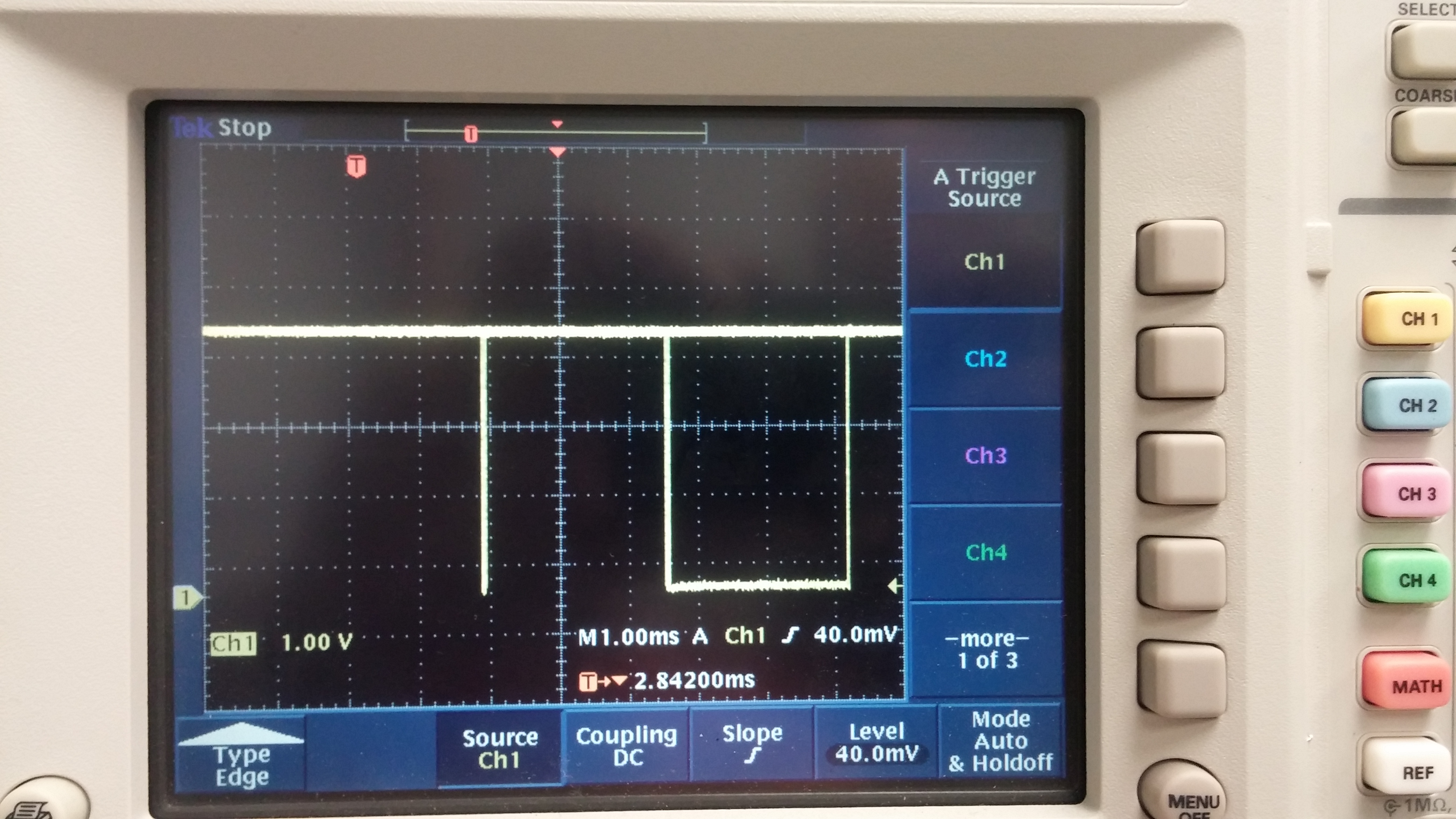

I'm working on connecting a few I2C chips to my TM4C129X EK board, so far I am able to get output but the output isn't what I am expecting. In the case of the MCP4725 chip I am seeing some behavior in the clock line that I am not expecting, A picture of the oscilloscope reading is attached, and the code I am using is below that (partially borrowed from another post). The VOUT line and the SDA line also appear to be reading 0. Any advice or help would be appreciated!

  • Hello Adam
    Have you connected a Pull Up on the SCL and SDA? Also the Scope plot shows a signal at about 3.6-3.8V. Why is that so?
    Also please send a scope plot zooming in to the strange behavior!!!
    Amit

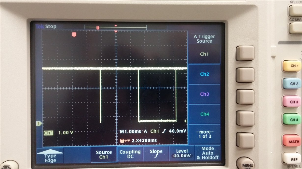

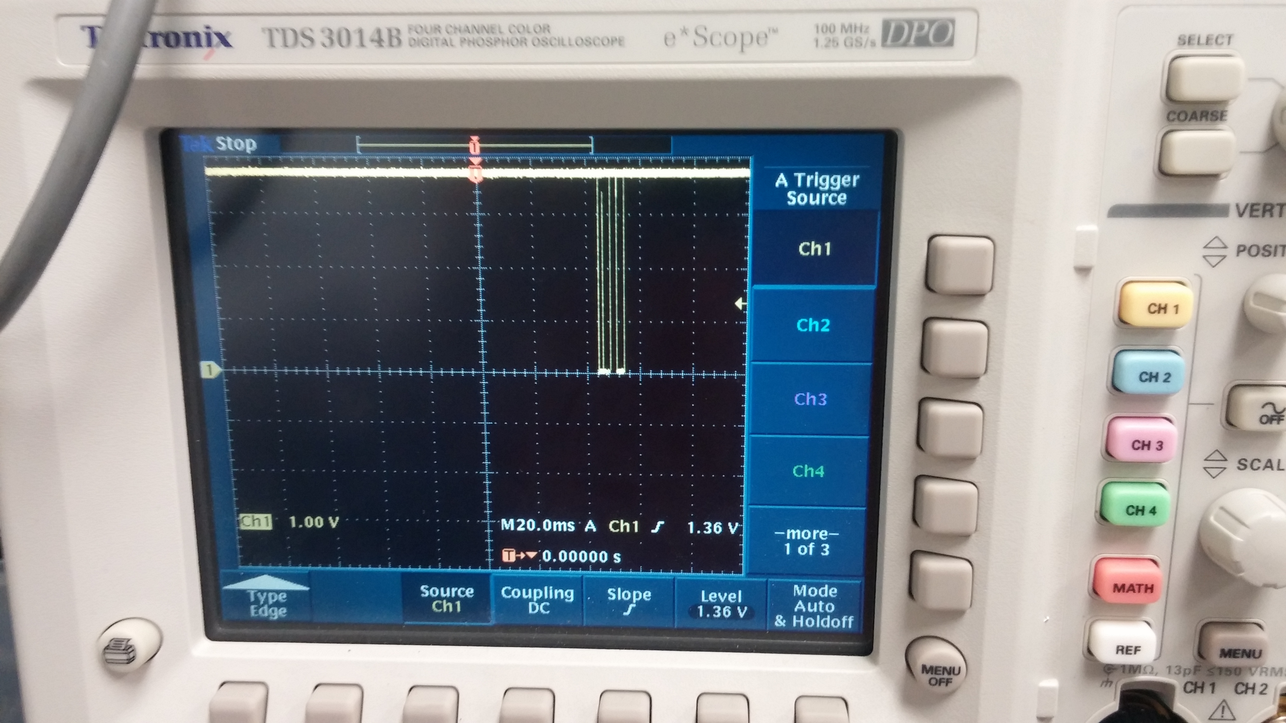

  •  We did connect a pull up resistor. It looks like we got the software to work by not sending the address bit twice.
    However we did switch back to the other chip , the INA219. We're still getting strange behavior for the clock line. Are there any other pitfalls we should be keeping our eyes out for? The scope behavior for our new issue is attached once again, zoomed in as much as we could get.
  • Hello Adam,
    I am not sure why the waveform is showing up like this. Is the persistence mode in the scope switched ON. Also the resolution for the transaction can be improved to show the SCL behavior.
    Amit
