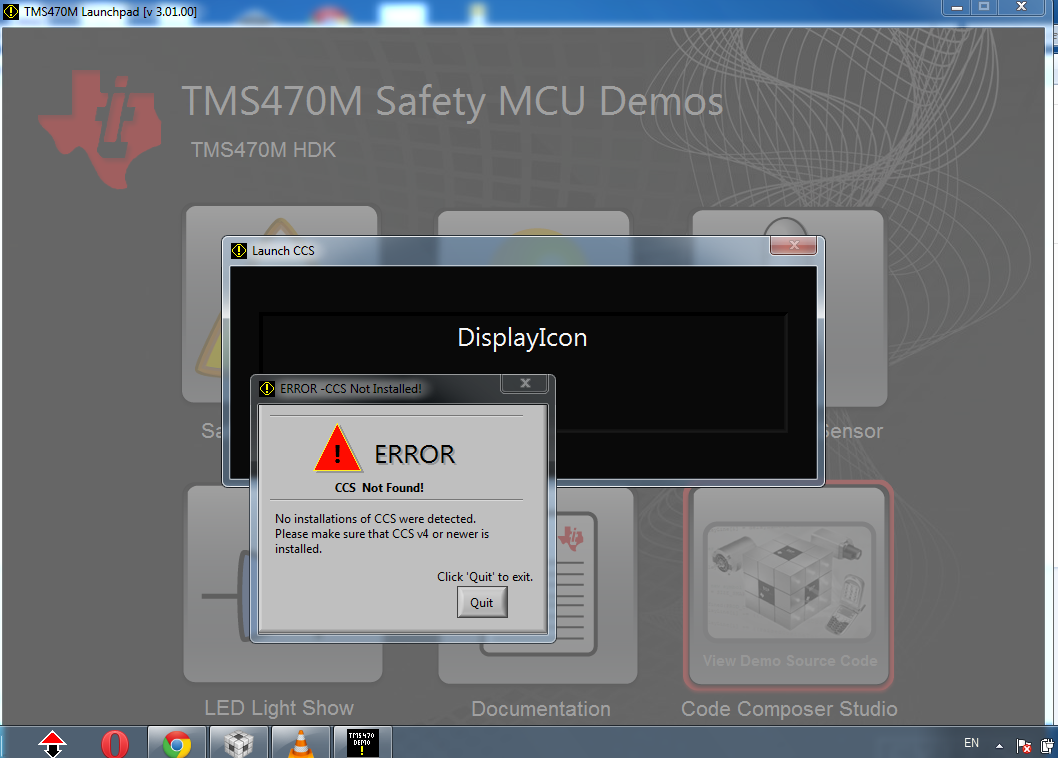

 I have installed the CCS 5.3 in my PC(Windows-7 32-bit) and trying to run some demo codes on TMS470M HDK . I am getiing error in opening the CCS demo codes in TMS470M safety MCU demos tool.I have attached the error message.
Can anyone help me to solve this error?

    How did you install CCS and the Safety Demo Software? From the DVD?
    If this is the case, the version on the DVD are old and it is recommended to download CCS and the Safety Demo Software from the WEB.
    Here are the link to the corresponding page.
    Safety Demo Software:
    The current version is V4.0.0
    Code Composer Studio:
    Latest Release is V6
    Halcogen:
    The latest release is V04.05.01
