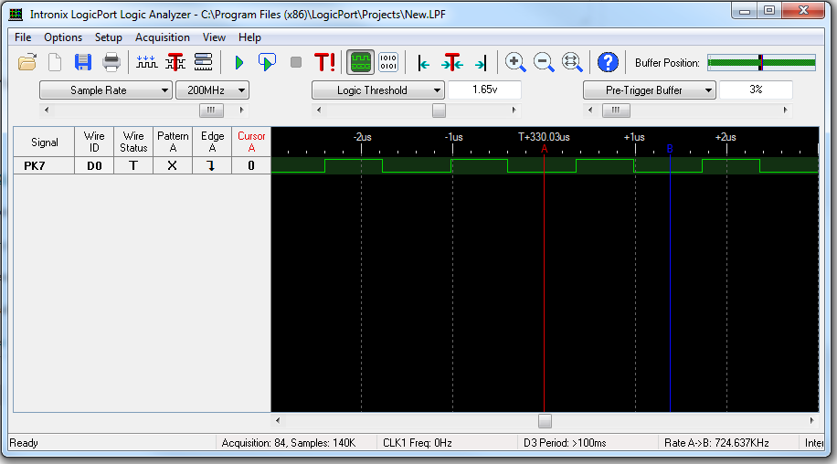

  • I have an ocsilloscope probe on Port K - Pin 7 - there is NO LED connection. I have a EK-TMC4129EXL does that make any difference. The driver library code does not work is all I know.
  • I can download the modified blinky example that I showed you and the Port K - Pin 7 shows the waveform I expect. I download the driver library example and Port K - Pin 7 is 0 Volts.
  • Hello Mark,
    I switched to EK-TM4C129EXL as well and it works. Attached is a LA snapshot for the same
    Amit
