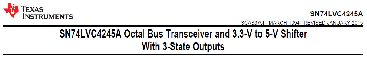

  • My "level translating obsessed" friend - does your protest not suggest that you'd benefit from expanding your search to "more accommodating" MCUs?  (they do exist)
    As a public service (and in satisfaction of my "work-release") - I relist vendor's, "SN74LVC4245A" Octal Bus Transceiver which exhibits superb voltage translation capabilities.   Device is prominent w/in:

  • cb1, Typo, I think. Should be SN74ALVC164245 ?

  • Note that a quick digikey search on level translators returns something like 3500 possibilities and digital isolators returns 3000. There's an embarrassment of alternatives available.

    We gutted an "enemy machine" to better gauge, "What, why, how" and the part I listed revealed.
    Do feel free to, "Make the case" for the device you've listed...   (my suggestion was not "end-all - be-all")
  • Robert,
    Device you listed is vendor's "wide-body" and is 16 bit.   I proposed 8 bits - moving Brett's ball more slowly/cautiously to the goalposts...
  • Cb1, Aha! The SN74LVC4245A shows up, the previous one mentioned did not (check the spelling, a few letters got transposed)
    The SN74ALVC164245 is listed as an 8 bit device on Digikey, I didn't notice the fact it was listed as 2 channels of 8 bits. The perils of skimming
    Robert
  • @Robert,
    You "skim" - I can't, "proof-read" - both resolved now... And the "wealth" of riches should induce "reasonable" users to, "come aboard."
    Perhaps of note - device I listed was used by several "big-time" firms - our belief - their sourcing/testing/approving dwarfs ours - thus we, "follow in (near blind) lock-step."
  • CB1,
    Of worthy note, the cost appears comparable to the discrete solution for 8 I/Os
    Robert
