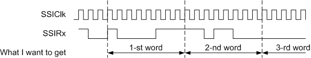

I strongly need to use SPI with DMA in the receiving mode without the frame synchronization. I tried to use Motorola modes (when SPI becomes active if you set 0 on the FSS pin) but I've got a fail. Regardless of which level which I set on the FSS pin SPI doesn't want to receive an information. It seems like receipt is possible only by the edge of the FSS signal not on the constant level on it. Is it true? Is it possible to receive without FSS at all?

    I think the main problem is ability of hardware perform that operation. The SPI port works as slave so it can't produce clocks and frame synchronization (receiving SSI has 2 pins only: SSLCLK and SSIRX). Is it possible to receive a signal without the frame synchronization?
    In order to describe the problem I publish a drawing:
    The position the edge of the frame doesn't matter.

  • Pardon - but does not your (own) drawing (strongly) support the NEED for the FSS/CS pulse?
    Minus FSS/CS - how does the process ever (effectively) start or end?   (your drawing shows SSIRx activity prior to "1st word.")
    It may well be that the MCU's internal logic paths require the FSS signal to become fully enabled.   (that's the case w/in "other" ARM MCUs)
    FSS potentially (likely) allows the SSI module to be selectively "enabled."   If "on/enabled" forever - it's extremely vulnerable to noise bursts/impulses - is it not?
  • It's easily to understand if you recall a situation when the microcontroller works with an audio codec - the data stream from the codec is infinite, but you don't get any negative situation.
    I can recognize the start of the frame by my own DSP algorithm so I don't need any external signal for that.
    Since it's impossible to use SSI in a slave mode without FSS I will make an external hardware for that. It will be a counter and a few logic elements to provide an artificial FSS signal to the SSI port.

  • Sorry, I don't exactly understand your idea. Could you draw a schematic diagram?
    Generally, the idea of an external synchronization is based on the following principles:
    1) FSS signal must be synchronized with the clock signal (jitter must be as small as it possible).
    2) FSS signal must occur once per 8 bit.
    3) I can't receive any additional signals over a communication link except clocks and data.
