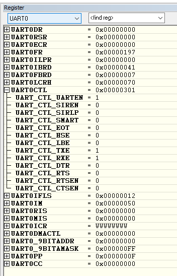

I am able to run the uart_echo sample project on my DK-TM4C129X dev kit board without any problems. When I connect a terminal emulator program to the USB debug port on the board, I see the "Enter text:" prompt, and any characters I type get echoed.
However, when I try to talk to the UART from my custom project I am not able to duplicate the functionality of the sample project. My code tries to write a string ("Testing") to UART0. When I single step through the code, I see that every time I call UARTCharPut() two bytes get received by the terminal emulator. The second byte is always 0xFF, and the first byte bears no resemblance to what I am trying to send.
For example, when I try to send "Testing" I get the following bytes received by the terminal emulator:
28 FF C9 FF E7 FF E8 FF D1 FF DE FF CF FF
Another odd thing is that if I run at full speed I do not see all the characters sent out. Instead, the terminal emulator receives
28 19 21 FF
Since UARTCharPut() is supposed to block until the tx is ready, this is very puzzling.
I compared my UART0 register settings against those in the uart_echo project, and they are identical:
Any idea what could cause this behavior? There must be something different, but I have checked stuff all day long and have come up with nothing.
Dave
  • Two things to check. Your terminal emulator's settings and the actual bit sequence sent. Best guess is a baud rate mismatch, a simple scope check is really a necessary sanity check.
    Robert
  • Hi, Robert,
    I had dismissed the idea of a baud rate problem since my code is setting the same baud rate as the sample code (which works fine), and even checked that the UART's control registers (including the baud rate dividers) are identical to the sample code.
    However, your post got me thinking about this again, and if the baud rate were off by a factor of 2 that would certainly explain what I am seeing. What might be happening is that the system clock is not the same between the 2 systems. They are supposed to be both running at 120 MHz, but the example code is using a TivaWare call to set the clock, and my code is using an RTOS function to do it. It may be that there is a bug that is causing the clock to be off, which would affect the baud rate.
    I will look into this when I get back into the office on Monday, and report my findings. Thanks for the post!
    Dave

  • I did a little testing of things, and as I had surmised on Saturday after reading Robert's post, the issue is not in the configuration of the baud rate per se, but rather that for some reason the system clock frequency in my custom code is different from that in the example code. I added a call to MAP_SysCtlClockFreqSet() to set the freq to 120 MHz, and now things are working fine.
    Next on the list is to figure out why my code is not setting the clock to the frequency I thought it was!
    Thanks again for steering me in the right direction regarding this problem. It's another example of how the assumptions we make (in this case, my assuming that since the UART was configured the same way in both my code and the example code, the baud rate must be the same) can interfere with the debugging process!
    Dave

  • I believe I have discovered 2 bugs in the RTOS' clock initialization code. The first one is pretty major. The PSYDIV field in the RSCLKCFG register is being set to 4 instead of 3. They divided the 480 MHZ VCO by the 120 MHz desired system clock, but neglected to subtract out 1 to get the proper PSYDIV value.
    The second bug might or might not be important. The value being written to the MEMTIM0 register is 0x01B6.01B6 instead of the proper 0x0195.0195 value. They appear to be using the wrong table to set the values. They are using:
    * +-----------------------+--------------------------+-------------+-----------+---------+ * | CPU Freq. Range(F) in | Time Period Range (t) in | FBCHT/EBCHT | FBCE/EBCE | FWS/EWS | * | MHz | ns | | | | * +-----------------------+--------------------------+-------------+-----------+---------+ * | 16 | 62.5 | 0 | 1 | 0 | * | 16 < f <= 30 | 62.5 > f >= 33.3 | 1 | 1 | 1 | * | 30 < f <= 50 | 33.3 > f >= 20 | 2 | 1 | 2 | * | 50 < f <= 60 | 20 > f >= 16.67 | 3 | 0 | 3 | * | 60 < f <= 80 | 16.67 > f >= 12.5 | 4 | 0 | 4 | * | 80 < f <= 100 | 12.5 > f >= 10 | 5 | 0 | 5 | * | 100 < f <= 120 | 10 > f >= 8.33 | 6 | 0 | 6 | * +-----------------------+--------------------------+-------------+-----------+---------+
    The datasheet I have for the TM4C129EKCPDT shows different entries in the table:
    The TivaWare MAP_SysCtlClockFreqSet() sets up the MEMTIM0 register properly according to the chart in the data sheet. The EEPROM seems to work okay using the incorrect register values, but that might just be the result of luck.
    I will be contacting Micrium regarding these problems.
    Dave
