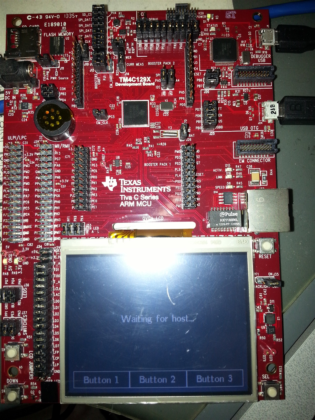

I'm porting my LM3S9B96 application with its bootloader to my new TM4C1294KCPDT. Everything now seems to work (thanks to suggestions) except USB in bootloader. So to check if this is a software rather than an hardware problem, I tried to load a Tivaware demo, and it also failed. Not sure about the demo was working, I tested it on the evaluation board and... surprise! It's not working also on that board. So? What to do now?
Let's start from the beginning: the demo I'm trying is boot-demo-usb located in "SW-TM4C-2.1.1.71\examples\boards\dk-tm4c129x\boot_demo_usb". The demo should show up a composite device with a simulated mouse and a DFU interface (ok, perhaps I should have chosen a simpler demo, shouldn't I?).
Loading firmware with ICDI and starting application shows the "Waiting for host..." message on screen. Connecting the USB cable in the USB ON THE GO connector does not change anything. Device does not show up in Window's Device Manager.

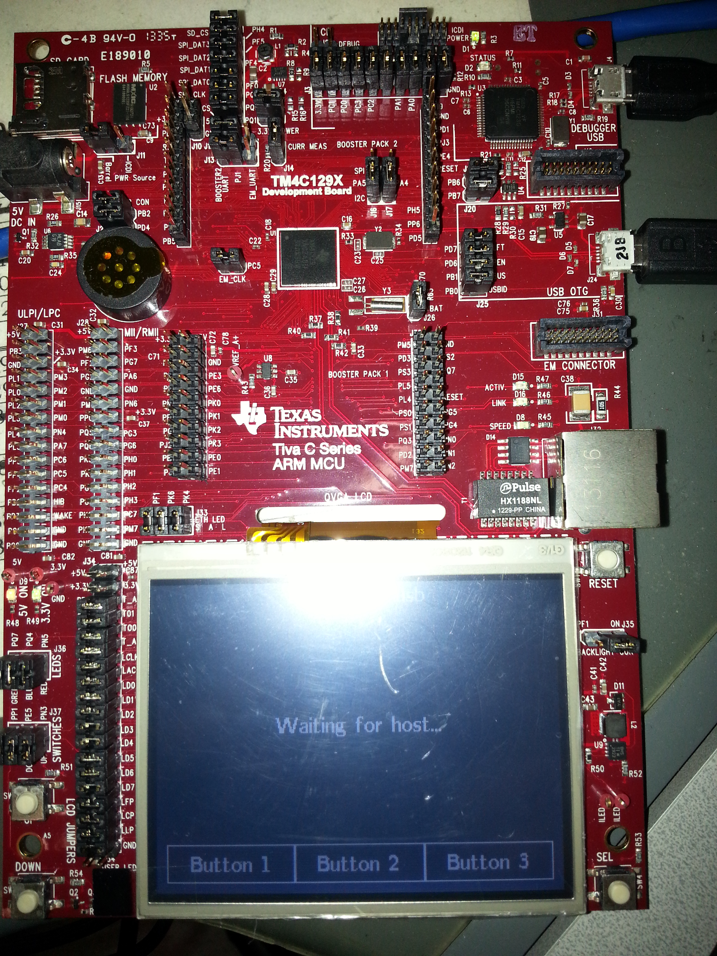

  • Hi Amit,
    I tried to load the precompiled executable with LMFlashProgrammer, but results are the same:
    Board is powered with external supply. All jumpers should be in the correct position.
    Do you think the board can have some hardware problem? Is there any other test I can do?

  • Hi Amit,
    I tried as you suggested to fully erase flash and... WOW USB DFU appeared. I was able to load boot-demo-usb with LMFlashProgrammer by DFU, so I can confirm that USB is correctly working. But now, what can be the problem with the demo code? It still does not show up in device manager. Do you have a board like mine to test?
    Stefano
  • I also tried to do the same thing on my own custom device, and internal bootloader works even without VBUS and ID pin, i.e. only with DP/DM. I was able to firmware my bootloader with the internal bootloader! I only have to discover why USB is not working in my own bootloader...

  • Hi Amit,
    finally I managed to make it work!
    I started from this article in the wiki, found searching on the support forum. So I had the suspect that device was not properly turning on in device mode. I modified the source code of boot-demo-usb adding the following line
        // Set the USB stack mode to Device mode with VBUS monitoring.
        USBStackModeSet(0, eUSBModeForceDevice, 0);
    just before USBDHIDMouseCompositeInit call, and suddenly boot-demo-usb started to work.
    Then I did the same test on usb_dev_serial demo. The plain code was not running on my demo board, no USB interrupt arrived. So I opened usb_dev_serial.c and changed the following line
        USBStackModeSet(0, eUSBModeDevice, 0);
    into this one
    and also usb_dev_serial demo started working.
