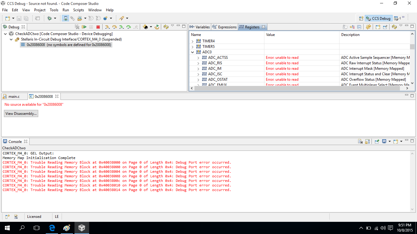

tm4c1294ncpdt.hHey,
I'm using TM4C1294 and was trying to configure 6 ADC channels, my code was working the first time I ran it but wasn't reading the values, so I just unmasked the ADCIM bit and after that it has totally stopped working even after reverting back to the previous code. I've tried everything but still no success, can please someone help me find the problem? I've attached the screen shot along with my code.
Thanks for the help and time.
P.S. I just changed this line before it stopped working
ADC0_IM_R &= 0X0;
to
ADC0_IM_R = 0X01;
  • Hello Arsalan
    Please avoid using the DRM method and instead use the TivaWare API's. It will help us debug the code better.
    In the current code when the IM bit is set the interrupt to the CPU gets generated. Do you want to use the interrupt status or the interrupt handler to read the data?
    Amit
  • Hello Arsalan,
    Looking at the screen snapshot it is evident that the ADC0 clock has not been enabled after the new program has been loaded. Also you have not run the code yet and that is why it may be showing the error.
    Also there is no address space defined for 0x20086008. Please check the cmd file for the project
    Amit
