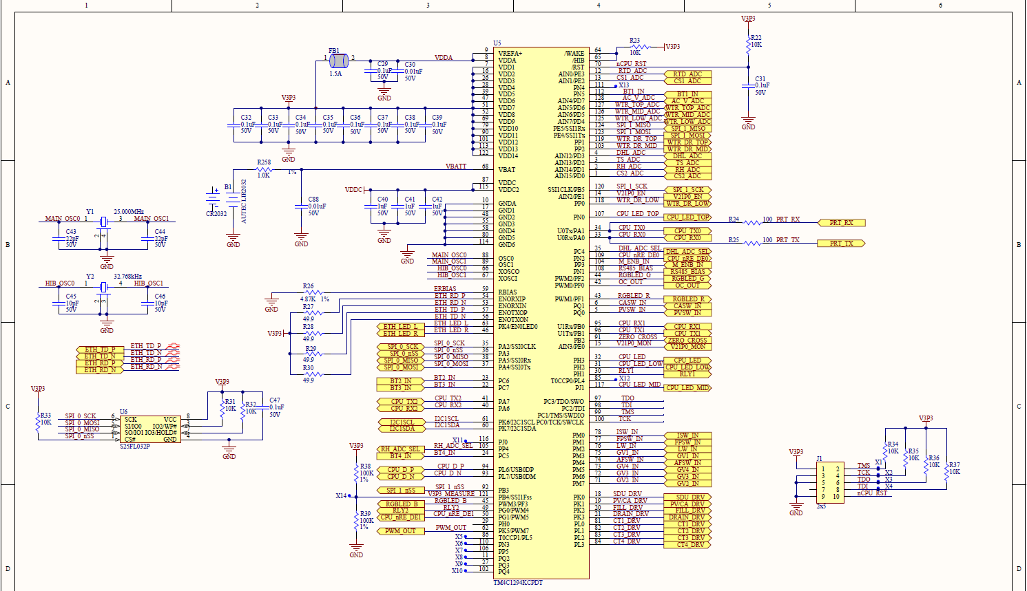

TM4C1294 battery drain help
I have a CR2032 battery powering VBAT (pin 68) on the subject chip.  The battery is to keep the internal RTC running.  The resistance from the positive terminal to ground with the battery removed and PCB not powered is 880K ohms.  Current measured to VBAT is 0.13mA when the PCB is not powered and the battery is supplying power.  VBAT is the only connection to the battery.  What may be causing the excessive current draw?  My battery is discharged after a month.
