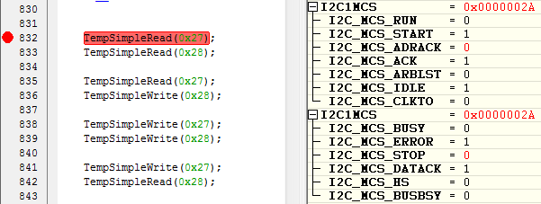

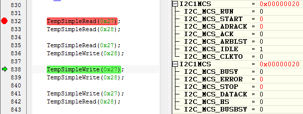

The issue that I've come across relates to the Error flag - Bit 1 in the I2CMCS (read) register:

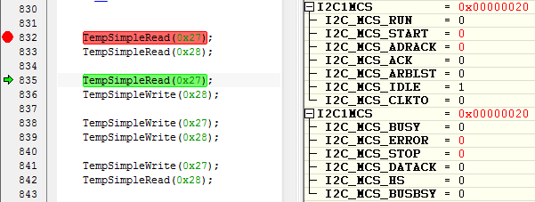

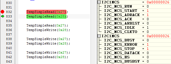

When I READ a single byte from the non-existent I2C slave (0x27), then the Error bit (Bit 1) is set. A successful follow up READ or WRITE from the existing slave (0x28) then clears the Error bit. This is expected behavior.
However, when I WRITE a byte to the non-existent I2C slave (0x27) and the Error bit is set, then a successful READ will not clear the bit. Only a successful WRITE will clear the bit. This essentially indicates an error for every successful READing that follows a single unsuccessful WRITE.
The only way that I've found to clear the Error-bit is by resetting the I2C peripheral with "SysCtlPeripheralReset(SYSCTL_PERIPH_I2C1);" and then reconfiguring the peripheral, or by successfully writing to an I2C slave
This behavior of the Error-bit seems out of place at least because I haven't seen anywhere that says a failed write will jam the status register. First off, is there any evidence that this behavior is expected? And secondly, besides resetting the peripheral or writing to an existing I2C slave, is there something that I can do that will allow for a successful read to clear the Error-bit?

  • Hello Timothy
    I checked the design and I see the issue with the Write frame to a undefined Slave. This is because after the ADDR NAK, the master will send one byte which will also create a NAK (DATA NAK). While the Address NAK gets cleared when a valid Slave Address is selected, the DATA NAK can only be cleared by a Write I2C Frame.
    The only "true" WA to this issue would be to Reset the Peripheral.
    Amit
