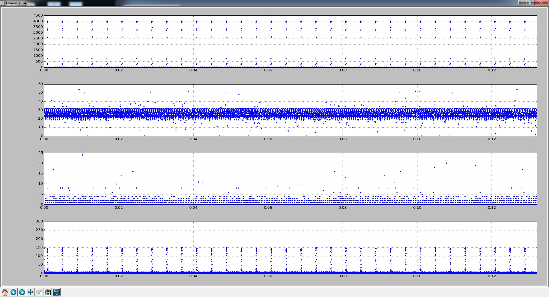

I have a product based on the TM4C123GE6PMI and I'm having crosstalk between ADC channels.  My setup/configuration:

So the Tiva part gets triggered and kicks off the ADC with this configuration pre-loaded.  At power up the Initial configuration is run.  After that and some other system configuring (GPIO, USB etc..) the mode configuration is run.  This is run separately because the speed and number of channels are configured based on parameters stored in EEPROM.  So the params might say run 1 channel at 500k or 4 channels at 1k etc...
The ADC0 is always configured to run at 500ksps per the
SysCtlADCSpeedSet(SYSCTL_ADCSPEED_500KSPS);
instruction.  So if I want to run 4 channels I effectively get 125ksps/channel.  The problem I'm seeing  with is when I run 4 channels.
So, to recap the above configuration is what I'm using in this exact situation recording 4 channels with ADC0 speed set to 500k.

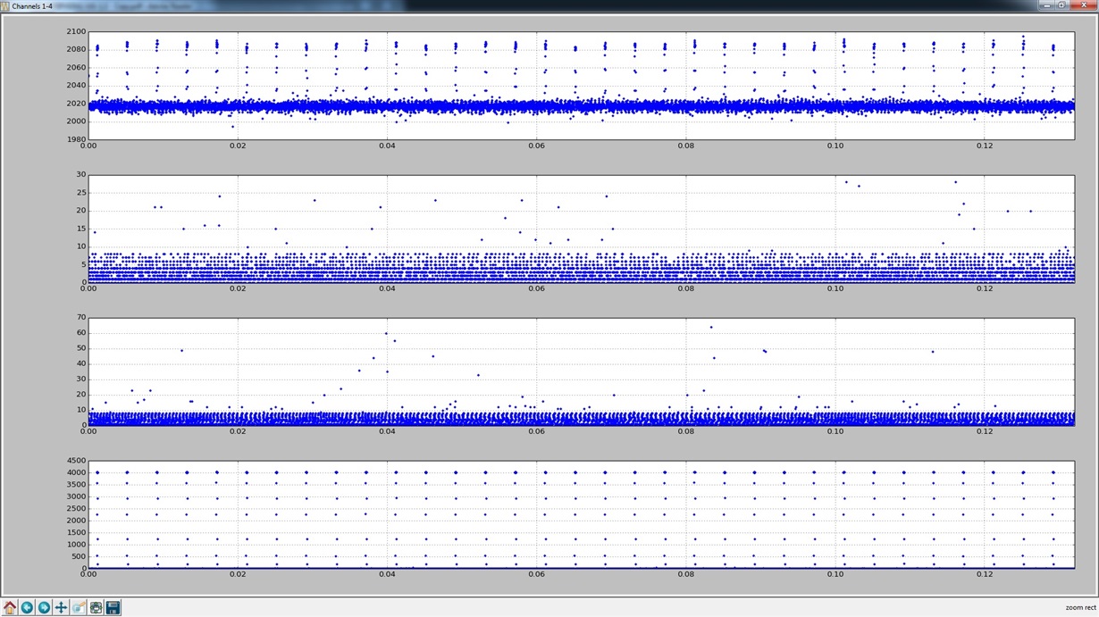

The problem I'm having is this:  If I put a PWM signal into channel 4 and run with the ADC0 configured as above, I get a little bit of the signal in channel 4 bleeding over to channel 1.  So in other words If I run a 3.3V pwm signal into channel 4 with channels 2 and 3 grounded I see the below plot...
Channel 1 really should be around 0v (roughly) like channels 2 and 3.  Some how channel 4's signal is  getting into channel 1.  I thought I would be pretty safe running this at 500k since it isn't the max speed.  I would have though the adc cap could discharge pretty easily by then.  I'm not sure exactly what is going on.  The input of channel 1 has an op amp driving it, but the op amp is AC coupled.  Shown below:

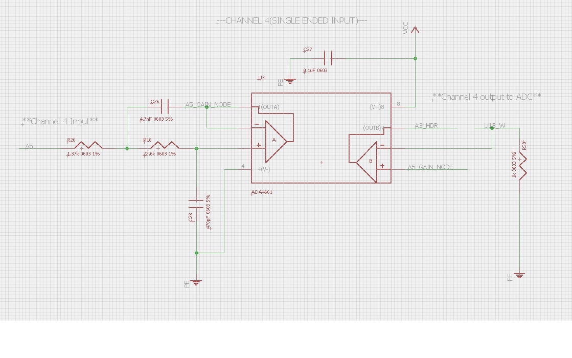

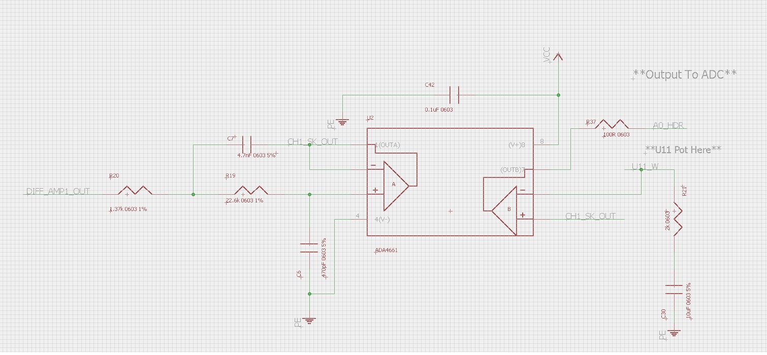

The PWM signal comes in through R20 (Sallen key LPF) and then into a gain stage.  Between A0_HDR and U11_W nets is a digital POT which allows me to adjust the gain via I2C.  The 100R is inline with the output as recommended by analog devices for stability.  So yes, the 100R is IN SERIES with the ADC0 Channel1 that is experiencing this problem.
I don't see this problem when I put a scope probe at the input of channel1 and let the pwm signal run continuously through this analog circuit.  I ONLY see this pulses on ch1 when I sample the four pins with the ADC.  I'm not sure if this is a ADC configuration problem or a problem with the way I'm driving the channels, but I'm out of ideas troubleshooting and am looking for some new fresh perspectives/ideas.
If anyone has any insight it would be helpful.

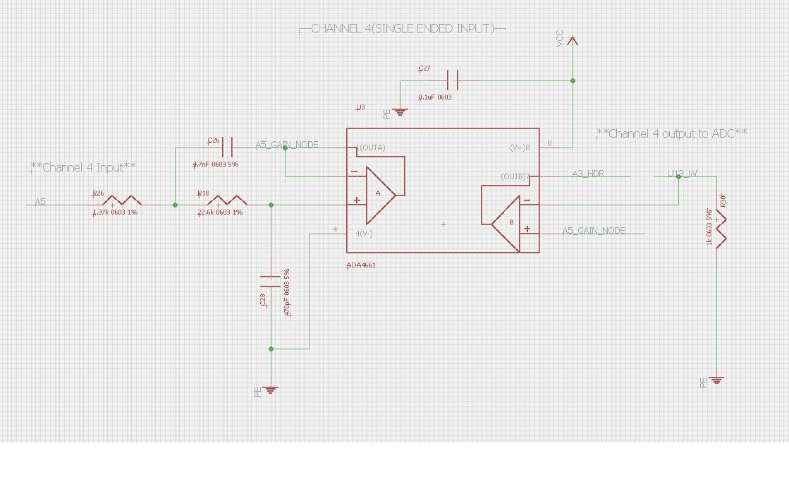

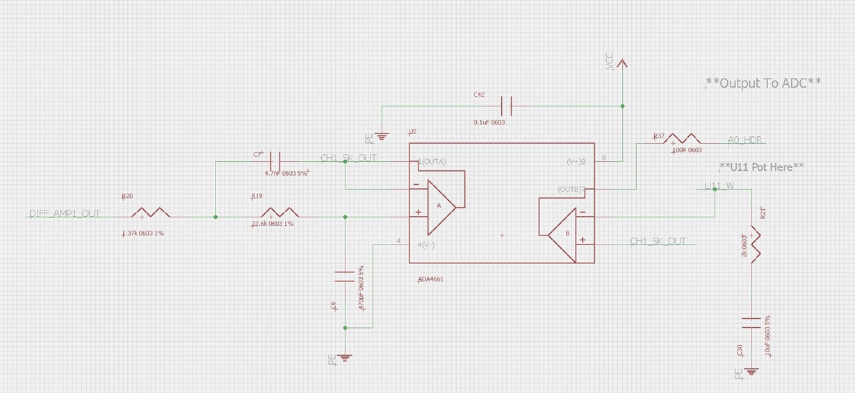

As a note for what circuits are driving what channels (ch1 -> ch4) the above op amp circuit is driving channels 1 and 2.  The below circuit is driving channels 3 and 4.  I DO NOT see this problem on channel 3 when the ADC channel 3 pin is ungrounded and left being driven by the below circuit so I'm leaning towards this possibly being an issue because ch1 and ch2 opamp circuits are ac coupled and don't drive a "DC" signal into the pins as the below circuit for ch3 and ch4 do.
The break between nets A3_HDR and U13_W is where the digital POT goes allowing me to adjust gain here just like above.  The big difference is the AC coupled part but I don't understand how this could produce this problem.
Rob
  • Also forgot to mention. When I run in this manner but instead of constant sampling I trigger more slowly off of a timer this problem goes away. I leave the adc configured to run at 500ksps, but I use a timer to trigger the adc to sample say 50ksps so the timer kicks off the adc 50k times per second I don't see this issue. It seems to be that I'm running at 500k per 4 channels in the constant sampling mode.

  • Hello cb1
    I do see the errata taking affect here where the channel 4 is bleeding into channel 1.
    Robbie,
    Instead of sampling 1-2-3-4, if the order is changed to 4-3-2-1 do you still see the issue?
    Amit

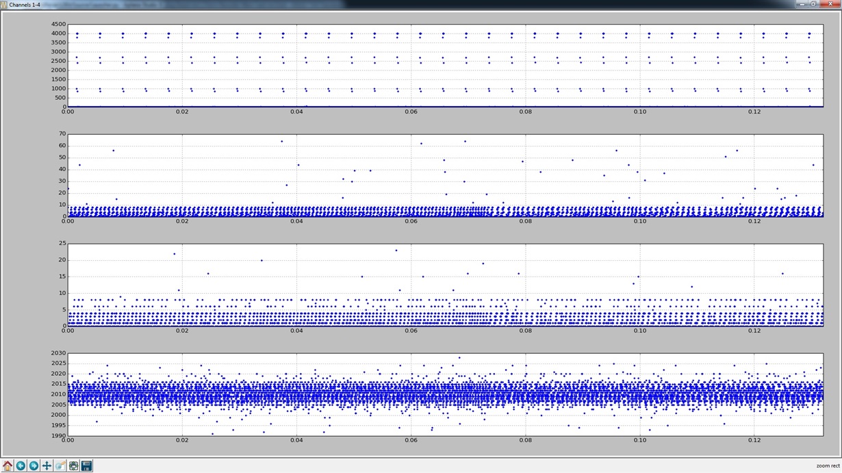

  • Hey Guys,
    First thank you for the responses!  This is extremely helpful to me you guys are great!  Now, Amit for some reason I didn't even realize how easy it is to switch channels in the sequencer.  Thanks for pointing that out.  The first thing I did tonight was make that code mode and sampled 4-3-2-1 instead of 1-2-3-4.  The code was exactly how you recommended:
    	ADCSequenceStepConfigure(ADC0_BASE, 0, 0, ADC_CTL_CH3);
    	ADCSequenceStepConfigure(ADC0_BASE, 0, 1, ADC_CTL_CH2);
    	ADCSequenceStepConfigure(ADC0_BASE, 0, 2, ADC_CTL_CH1);
    	ADCSequenceStepConfigure(ADC0_BASE, 0, 3, ADC_CTL_CH0 | ADC_CTL_IE | ADC_CTL_END);
    I did a test run at this point so no hardware modes, no ADC input caps etc....only this software mod.  The results look MUUUCH better!! Here is a screen shot of my new data points.  Keep in mind that the top channel is now channel 4 or ADC_CTL_CH3's values so I guess really my channels now go 3-2-1-0.
    As you can see channel 1 (the bottom plot) now sits at ~2010 which is about about 1.65V which is ~(Vcc/2) which is correct.  In this product channels 1 and 2 which are the bottom two channels sit at 1.65 because there is actually an instrumentation amp behind the schematic I posted above for them that sets the DC output to Vcc/2 and my Vcc=3.3  So thats why that is there.  The reason you don't see this in the second channel (second from the bottom on the plot) is that the actual analog circuitry is not populated on this board for that channel and I've tied the ADC pin directly to ground.  Channels 3 and 4, top two channels, output a 0V steady state dc value.  It's designed this way because the first two channels have to capture a full wave response from a sensor and I need the entire wave form, but have no negative power rail so I basically biased it up.  Anyways, enough background hopefully this makes sense I've verrrrrry happy to see this.
    Now, the only issue here is that per Robert and ct's recommendation I believe I need the recommended caps even though this seems to be working.  I next added those (keeping Amits code mod recomendation) and ran a test run.  I got data shown below:
    I used a 0.1uF cap on each of the four ADC inputs.  These were connected directly to the ADC input pins via being soldered on the outputs of my op-amps.  It is the same net though and the boards are pretty small.  The ADC sample cap on my part per the datasheet on page 1377 is C_adc = 10pF.  The only cap I had on hand to try was a 0.1uF.  Now, maybe this is too big, but unfortunately this hardware mod seems to bring the issue back and actually worse than before.
    I agree with Robert and cb1 that I probably need a supporting flywheel (I think thats what you said TI called it) cap in there to help out, but I don't understand how it could make the problem come back and be worse.  Your explanations (Thank you very much for that write up Robert it was exactly what I needed and very well written!!) made perfect sense to me and I'm in complete agreement.

  • Hello Robbie
    There is an issue "A Glitch can Occur on pin PE3 When Using any ADC Analog Input Channel to Sample". Now based on the issue description and circuit, it seemed to me that what was samples last was affecting the channel-1. Also if it was switched to low speed sampling, the issue was no longer present, that meant a discharge path was being formed over extended period sufficient to get the S/H cap at the same level as the analog channel.
    Amit
