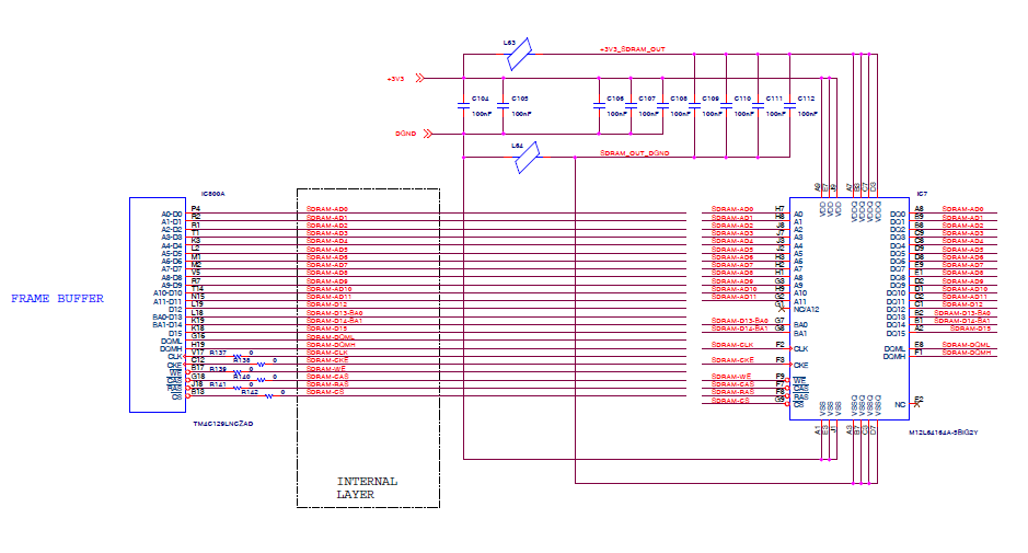

Hello.
I've done a simple project with TIVAC129, I mean a main() with a while(1).
The program init the SDRAM and LCD controller in order to display a simple pattern on LCD Screen (black or red backgroud).
The main issue is that after all init the LCD screen is doing strange behaviour: it continuosly roll over red, blue, green grey,... but I never init this values into SDRAM.
Which is the explanation of this behaviour?
Marco

  • Hello Marco
    I have worked with both Raster and Smart Panels with SDRAM on the TM4C129X devices and have seen no issue. Can you publish you code, schematics (as cb1 already said) so that others can check if there is an issue.
    Amit
  • The fact is that I have an application that run on TIRTOS and works fine with the same driver.
    The only difference is that this application is a simple main and I have no early configuration for port.
    Below my code:

  • Hello Marco
    I do not see if the IOs for the LCD controller or for that matter for EPI is being configured.
    Amit

  • Hi Amit.
    The SDRAM is 8MB.
    As you suggest I can avoid to reconfigure the SDRAM and try again.
    Attached there's also the schematics.
    Marco
  • Hello Marco
    The schematic is fine as well. Now comes the debug part. When you halt the CPU, can you check the contents of the SDRAM?
    Amit
    when I halt the CPU the content of SDRAM is all initialized to zero, so I suppose to see blank screen on LCD.
    But it's not true, the screen begin to roll between red, blue, green, and so on
    Marco
  • Hello Marco
    I think the issue is on the LCD Panel side then. Can you connect a LA and see what the LCD controller is sending to the LCD Panel?
    Amit
