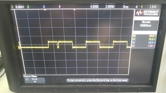

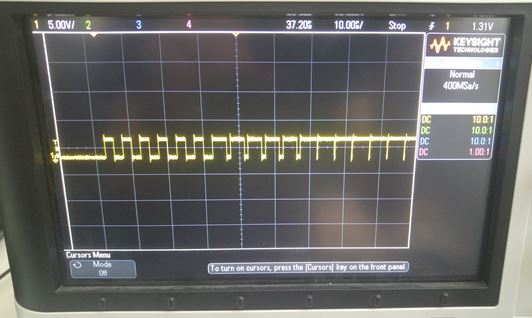

1. I'm getting problems with the first pulse each time I press the button.
The first time I press the button, I get a chain of pulses starting with this:
So I'm getting an unwanted extra first pulse.
The second time pressing the button, and the ones following that, give me:
Zoom-in on the first pulses:
So I'm getting a pulse adjacent to the first one I actually want (and it also has different width than the first intended one), and it apparently starts when the line enabling the output (PWMOutputState) is executed.

  • Hello Avner
    I think you are using immediate load instead of load on timeout. That would be the cause of the issue where the PWM Duty Cycle seems to be different for the first pulse after a change.
    Ours (and other vendors) DC output from PWM tends to have issues at the extreme ends of the DC. But that should be for DC where only 1-2 clock is involved and not early enough at 95%. 100% condition is not possible.
    Note that the condition is ZOH_counter is set for compare of 5. Hence it will count from 0 to 5 (which is 6 interrupts).
