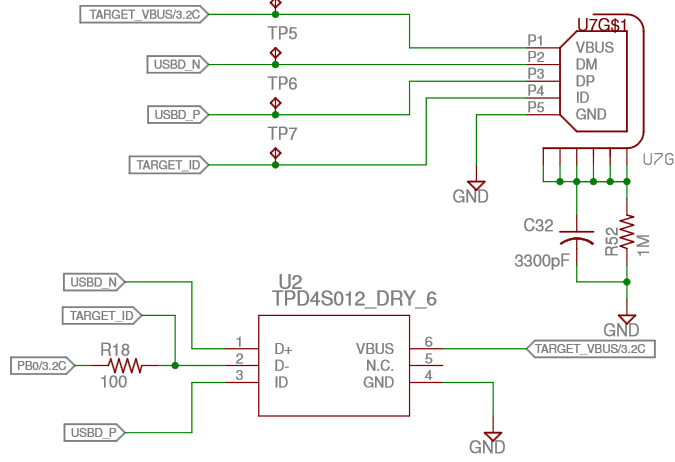

I am trying to make the USB FatFs works with few modifications. I found in the evaluation board documentation the USB circuit and verified that it was the same on the physical circuit. I think there is a problem. As you can see on the linked schematic, the D+ and D- lines are swapped, the ID line is connected to D- and the D- is connected to PB0 instead of PL7.
I tried several times to understand why the circuit was that way but I can't manage to find.
