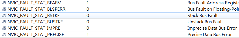

But the same code on my PCBA would jump into Fault_ISR (via XDS100v2)
This function would lead to fault_ISR on my PCBA.
PWMGenConfigure(PWM0_BASE, PWM_GEN_3, (PWM_GEN_MODE_DOWN));
->HWREG(ui32Gen + PWM_O_X_CTL) = ((HWREG(ui32Gen + PWM_O_X_CTL) &
                                     ~(PWM_X_CTL_MODE | PWM_X_CTL_DEBUG |
                                       PWM_X_CTL_LATCH | PWM_X_CTL_MINFLTPER |
                                       PWM_X_CTL_FLTSRC |
                                       PWM_X_CTL_DBFALLUPD_M |
                                       PWM_X_CTL_DBRISEUPD_M |
                                       PWM_X_CTL_DBCTLUPD_M |
                                       PWM_X_CTL_GENBUPD_M |
                                       PWM_X_CTL_GENAUPD_M |
                                       PWM_X_CTL_LOADUPD | PWM_X_CTL_CMPAUPD |
                                       PWM_X_CTL_CMPBUPD)) | ui32Config);
 and the NVIC_Register shows like
Other peripheral modules works fine (i2c, smbus, can, timer)
