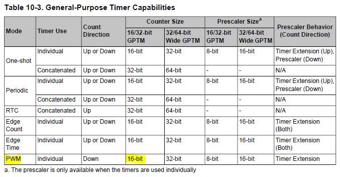

Perhaps the section 13.3.3.3 wording for edge mode has sound basis but seemingly makes no difference.
Edge count capture mode timer B up count auto resets 0x00 on match CHR count. So setting the load value higher than match seems plausible but setting load value higher than match makes no difference to either timer 5A/B asserting an interrupt for their handlers to then clear.
Why are the interrupts not asserting on a match count? -- that is assuming they should assert by timer design.

  • Your code:
       ROM_TimerConfigure(TIMER5_BASE, TIMER_CFG_SPLIT_PAIR |  TIMER_CFG_A_PWM | TIMER_CFG_B_CAP_COUNT_UP);
    causes one of the split (not splint) timers to count "down" (PWM one) and the other to count up.   Might that confound (surely complicate) any interrupt?
    Thru observation - counting up is most always - more problemmatic than counting down.   Switching split timer B to count down eliminates this (potential) issue...

    The CCP1 pin input TM5B is configured for an edge capture counting event and a triggered internal interrupt on match count that vectors to a handler. The CCP0 timer 5A PWM generator is configured for an internal match count interrupt vector. Even after setting load values for a 25kHz PWM & 50% duty cycle the reload match on down count never triggers that interrupt as it is expected to.
    Unlike edge capture down count PWM down count auto resets the TMbEN so it keeps PWMing after initiate. Produces a very nice 25kHz PWM with 50% duty and the fan runs at about 1350 RPM estimate. Changes to the duty cycle are now and remain static on initiate that is why the interrupt is needed for the update processes. I known you know that but put it here for anyone else wondering why PWM interrupt is needed.
    Updated PWM values in the code above.

    2.  From my take that is more for use in edge capture PWM monitor mode.  For basic PWM mode TAMR bits are already set in periodic timer mode so TAMIE needs to be set, it is not being configured. I have tried to or  TIMER_TAMR_TAPWMIE | TIMER_TAMR_TAMIE but that is not setting the bit in all this wacky shifting business. We have to be able to reload the timer on match up count order to adjust the duty cycle and it takes and interrupt on match or zero to do that effectively. Otherwise we would have to poll the TAV/TBV registers which defeats the purpose to use a timer for PWM. The idea in my opinion is to off load timer match events in HW interrupts so SW time is put to better use at this 25kHz PWM speed especially.
    3.  Does PM6 have a PWM signal on it, mine does. Now 25kHz PWM so I learning the hard way how to set the timer PWM frequency. The new PWM timer values are posted above.
    Timers configure need review set TAMIE match interrupt for PWM periodic timer mode. Match count in edges capture mode (Not PWM edges capturee mode) should be possible otherwise how do we let the timer know when the desired number of input edges counted matches our set number other than by interrupt source.

    Finally got the edge counter working with match count TAMIE,  part of the issue is the timer configuration is kludged. The other is the BmatchChr register is not 0x0000.0000 on POR is 0x0000.FFFF.  So the match load set has to be 0x003C or the match CHR interrupt never vectors the RAW match int.
    I broke down the ui32 configuration to analyze why it was not setting TAMIE on either timer A or B. The configuration is now setting TAMIE on both but TMRA is not interrupting on AmatchChr for what ever reason.  Recently remove the timer control event from TMR-A so it might still need that.
    Here is the configuration if you wan tot try it out.
    /* Set Timer-5 control register for
     * split half wide 16 bit timers */
     HWREG(TIMER5_BASE + TIMER_O_CFG) = 0x4;
    /* Set timer 5B mode register for PWM periodic down count mode with a match PWM count interrupt */
     HWREG(TIMER5_BASE + TIMER_O_TAMR) = (TIMER_CFG_A_PWM | TIMER_TAMR_TAMIE);
    /* Set timer 5B mode register for edge capture mode with up match edge count reload interrupt */
     HWREG(TIMER5_BASE + TIMER_O_TBMR) = (TIMER_CFG_B_CAP_COUNT_UP | TIMER_TBMR_TBMR_CAP |
                                                 TIMER_TBMR_TBCDIR | TIMER_TBMR_TBMIE);

    The same configuration would not set the seemingly necessary TBMIE interrupt bit in the configuration shown in first post. The configuration for the split mode timers mode to preform edge count matched interrupts will not set the TBMIE bit. Debug clearly shows TBMIE was not set on either timer half and only set the PWM interrupts. What ever that PWM interrupt does is a complete mystery just like EMAC0 interrupt 56 comes from where exactly.
    Perhaps the each timers PWM interrupt is somehow asserting the RAW match count interrupt? What number is the PWM interrupt in each timer half since the text does not elaborate that point what it does.  What is the PWM interrupt source number or does it assume each timers half interrupt source value?
    The timer block figure 13-1 is not showing the interrupts out from each timer half A/B and depicts it as an output from the Configuration/Interrupt block entering each of the timer counters.
    Figure 13-1 Seemingly depicts driving interrupts into the timer counters A/B in the direction of the arrow seems to be drawn incorrectly. Each timer counter chain interrupts the configuration Interrupt block not the other way around. No wonder this is taking days to make the edge counter work as its a bit confusing.
    >As for the PWM mode interrupt since you want the PWM to load at a specific time. I would suggest using the Edge interrupt being generated by the PWM mode and Load on Timeout instead of Immediate load.
    I don't need to count or capture the PWM edge time and the load immediate was a try to get the PWM interrupt to fire. Using load on timeout will not work in this case to force an dynamic and immediate change in duty cycle. Seemingly we have to force the timers updated load value during the match or load count interrupt cycle. Hence TAMIE once again should save the day.

    I found the problem is relative to when the timer is in 32 bit mode the PWM/Capture interrupts are asserted as expected however there no PWM signal (out) or capture (in) CCPx pins. Yet in 16 bit mode the vector interrupt fails for PWM yet works for capture mode. Found that out when switching to TMR4 and configured to do full wide PWM on a single pin.
  • It's only the (wide) timer which has 32 bit capability when in PWM Mode according to the MCU chart, below:
    Might this explain?
