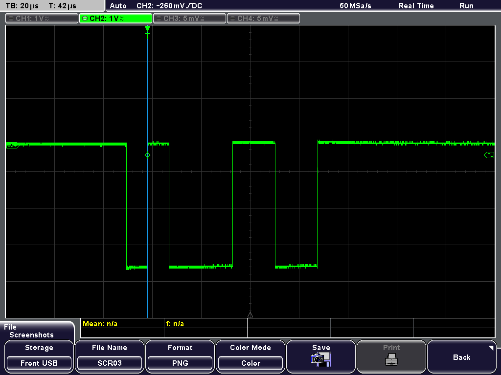

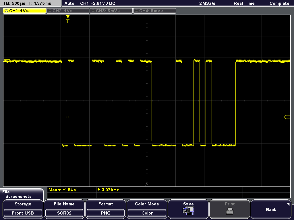

  • Ok so I got them both on the Oscilloscope and I can obviously see that the Arduino has much more information being sent and much longer than the Stellaris.
    Both of these boards are just sending a simple 1 on the output.
    This is the Arudino and it has 500us
    This is the Stellaris sending a 1 with the time spacing of 20us
    So I see the problem. However they are both set to 9600 baud rate so I don't know what to do.
    OK now - as you note this is immensely helpful - thank you!
    Now (from memory) at 9600 baud each bit should be ~104µS.   May I suggest that you change from sending your "1" to the hex value 0x55 or 0xAA?   Either of these values produce a repeating pattern of 1-0.   (or 0-1)  Both far more recognizable upon the scope.
    Clearly your data is far faster on the green (Stellaris) trace.   Note that earlier Amit noted your use of the standard I/O would default to 115K Baud - which is more than 10 times your desired (9600) rate.
    You need to read/review the UART API - and discover how to set the baud rate for your MCU...

  • Hello Cameron
    I think I know the problem. The uartstdio.c is using 16MHz to compute the baud rate, while the system clock is 40MHz. This yields a ratio of 2.5
    Now looking at the image for TM4C Transmit, the Start of Frame bit is ~40us which 25Kbps. You asked for a 9600 bps and this is a ratio of ~2.6.
    Check the uartstdio.c for the 9600 bps being set. I bet it is being done with an assumption of system clock or UART clock as 16MHz and not 40MHz. Also I checked the TivaWare 2.1.1.71 uartstdio.c and it seems that UARTStdioInit function is no longer there and instead UARTStdioConfig function is being used.
