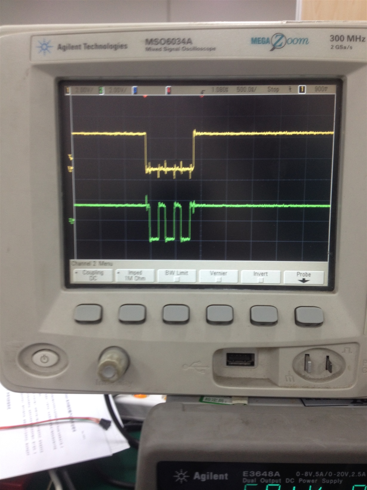

The error is every time I write an address a value, the EMIF_nWE have three times at low level during the one EMIF_nCS low level.And the following is the picture which give the view about the write process:
In the picture, the top line is view the EMIF_nCS pin level, the bellow line views the EMIF_nWE pin level.

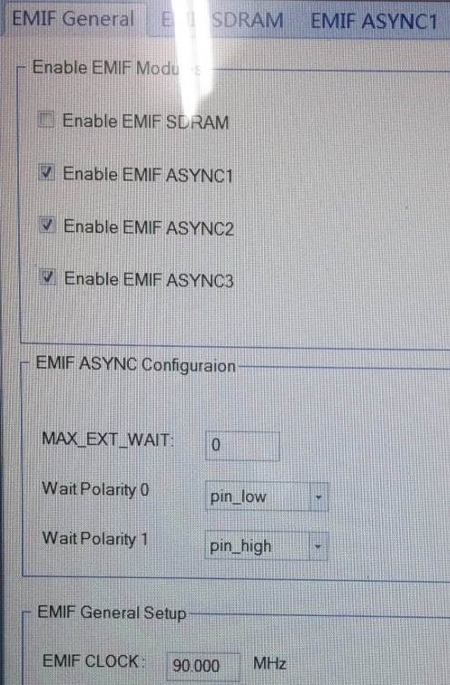

In the HALCoGen, the setting just like the follwing pictures:

and in this test process, I just write the Address a value.But the view is in one EMIF_nCS process have two or three times write process.
