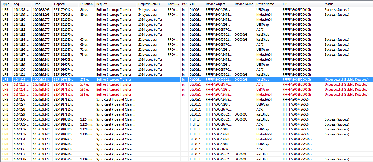

The problem i have are random disconnects from the device when communicating. libusb would return with error LIBUSB_ERROR_PIPE and when analyzing USB traffic i was able to trace it back to a babble error. There is no easy way for me to replicate the problem so i don't have a log for the error right now but i will post one once the error comes up again.

    USB communication starts out fine but after some time (sometimes 10 minutes, sometimes 10+ hours) the device disconnects (windows usb hotplug sound from the USB reset command) and my USB analyzer software reports a babble error.
    The launchpad USB device does not crash or reports any errors and i can reconnect from my PC software without problems again to continue communication.

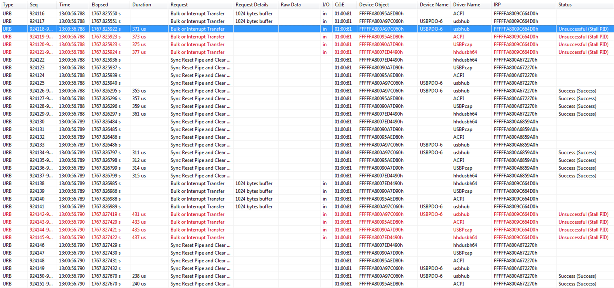

    I have tried several times with a different cable and am encountering a different error (Stall). The USB device firmware keeps running and after some time of Stall errors the endpoint stops giving errors and the transfers just time out.
    When sending data from the host (PC) to the device it is not received on the launchpad and the USB_TXIS/USB_RXIS are not getting set. I can also see the UNDRN and ERROR bits are set in USB_TXCSRL1.

    I do see 1024 byte packet. Could it be leading to buffer corruption? Without a LeCroy or Protocol Snooper it is going to be tough to know what is happening on the physical layer.
    Amit

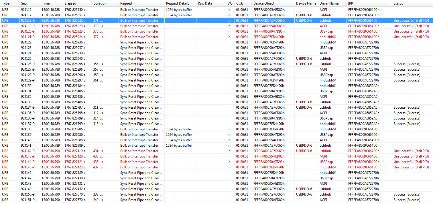

  • Hello again Amit,
    The 1024 Byte buffer you see is the host PC issuing an IN token (USB transfer (read) using a 1024 byte buffer).
    libusb_bulk_transfer (struct libusb_device_handle *dev_handle, unsigned char endpoint, unsigned char *data, int length, int *transferred, unsigned int timeout)
    The endpoint then responds with a stall.
    Sisco
  • Hello Fransisco,
    Are you sure that the packets being sent on the bus are being fragmented as 64 bytes packets since the FS mode has a restriction on the packet size in bulk mode as 64 bytes.
