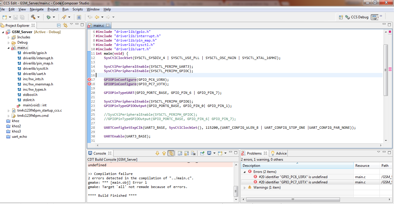

  • Hi Amit i didn't understand what is compilation log exactly but ithink this is compilation log:
    **** Build of configuration Debug for project GSM_Server ****
    "C:\\ti\\ccsv5\\utils\\bin\\gmake" -k all
    'Building file: ../main.c'
    'Invoking: ARM Compiler'
    "C:/ti/ccsv5/tools/compiler/arm_5.1.1/bin/armcl" -mv7M4 --code_state=16 --float_support=FPv4SPD16 --abi=eabi -me --include_path="C:/ti/ccsv5/tools/compiler/arm_5.1.1/include" --include_path="C:/ti/TivaWare_C_Series-1.1/" -g --diag_warning=225 --display_error_number --diag_wrap=off --preproc_with_compile --preproc_dependency="main.pp" "../main.c"
    "../main.c", line 17: error #20: identifier "GPIO_PC6_U3RX" is undefined
    "../main.c", line 18: error #20: identifier "GPIO_PC7_U3TX" is undefined
    >> Compilation failure
    2 errors detected in the compilation of "../main.c".
    gmake: *** [main.obj] Error 1
    gmake: Target `all' not remade because of errors.
    **** Build Finished ****
    also I attached project screen shot here:

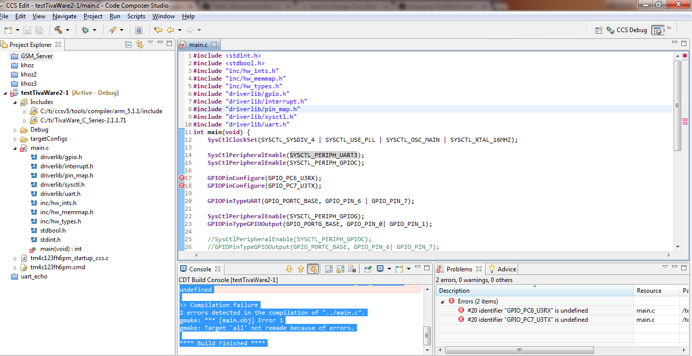

  • Hello Amit thank you for fast replays ,
    I tried new project with new setting, I don't know the way that I used for changing TivaWare is it correct or not but I have same problem again:
    this is results:
    **** Build of configuration Debug for project testTivaWare2-1 ****
    "C:/ti/ccsv5/tools/compiler/arm_5.1.1/bin/armcl" -mv7M4 --code_state=16 --float_support=FPv4SPD16 --abi=eabi -me --include_path="C:/ti/ccsv5/tools/compiler/arm_5.1.1/include" --include_path="C:/ti/TivaWare_C_Series-2.1.1.71/" -g --diag_warning=225 --display_error_number --diag_wrap=off --preproc_with_compile --preproc_dependency="main.pp" "../main.c"
    >> Compilation failure
    and this is screen shot:
    all the best,
    Siyavash

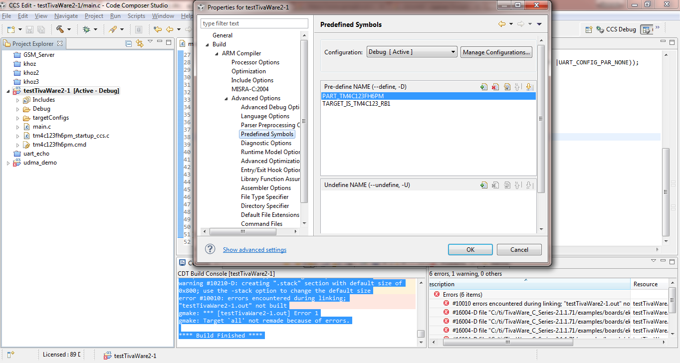

  • Hello Siyavash,
    The define for TARGET_IS_TM4C123_RB1 and PART_TM4C123FH6PM is missing as well.
    Amit
  • could you explain what I should to do exactly?
    excuse me I am beginner.
  • Hello Amit,
    Could you explain what I should to do exactly?
    best regards.
  • Hello Siyavash
    In CCS right click the project, go to "Show Build Settings". The go to Build -> ARM Compiler -> Advanced Options -> Predefined Symbols. Add the two defines in the box for pre define name
    Amit

  • Hello Amit,
    I correct it, I attached what I did:
    as you see in the picture it has 6 errors.

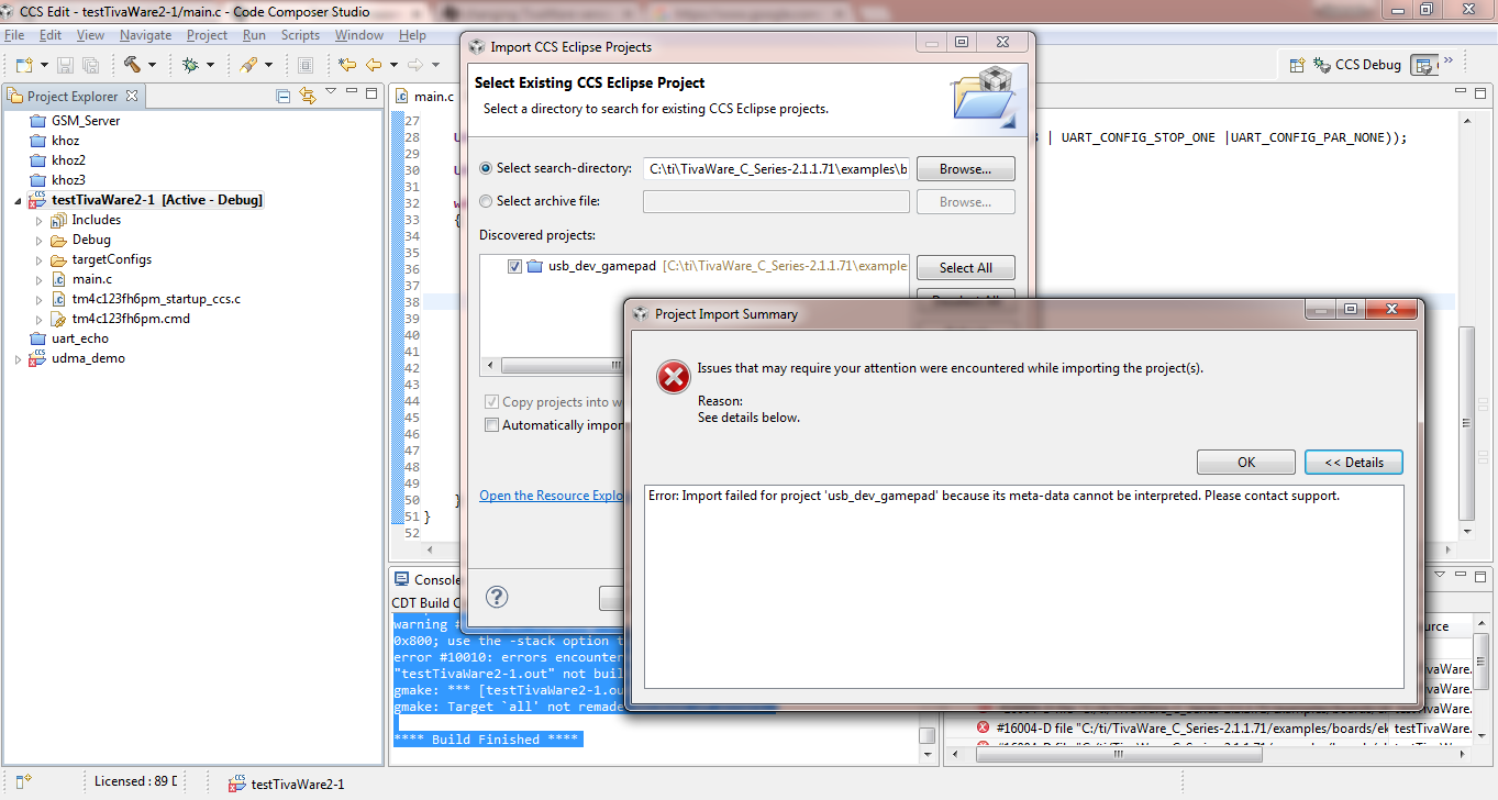

    about import when I tried import an exaple of TIvaWare2.1 this error occurred:
