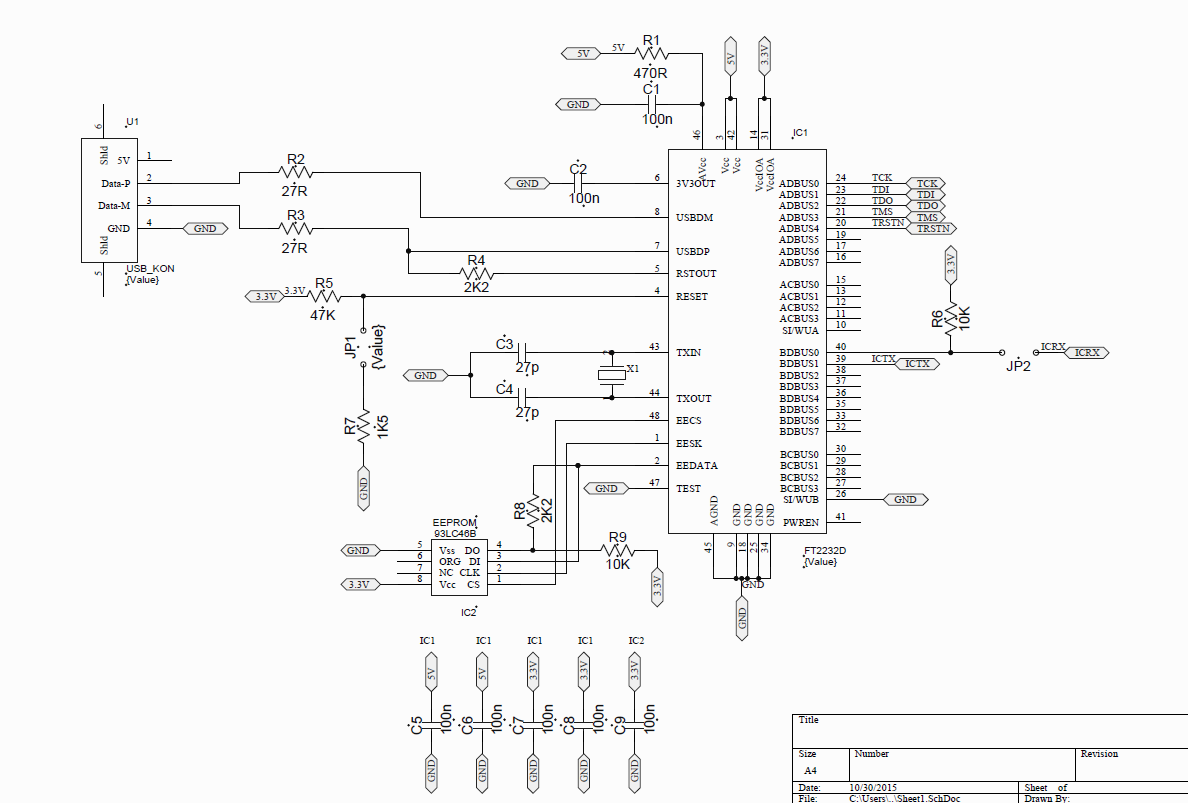

I developed my own board for debugging and programming my TM4C123GH6PZ uC with FTDI FT2232D. I have some problems. Firstly I did exactly what it is said in Stellaris-ICDI programming wiki page. In this page there is a guide for EEPROM programming for using FTDI device with Stellaris Development Kit. My FT2232D schematic is
After USB connection with my board, I can see com ports and USB Serial Converters like in pic I mentioned
In FT_Prog program I loaded ICDI.xml file for EEPROM configuration to create Stellaris ICDI com port . But after I loaded icdi.xml file mentioned in Stellaris ICDI wiki page, I couldnt see my EEPROM anymore in FT_Prog. After I change EEPROM on board I saw it again but again after reloaded icdi.xml file it disappeared again.
What am I doing wrong in here ? Any help will be great for me because It is the only starting point of this board.
