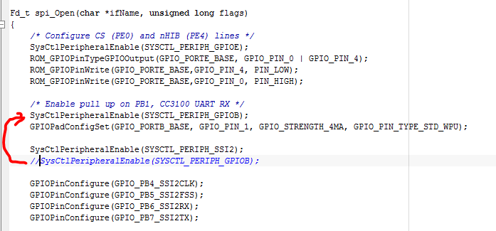

Good afternoon,
I'm trying to use the "getting_started_with_wlan_station" sample project included in CC3100's SDK using IAR. After replacing Tiva C libraries with the correct ones installed on my pc, as explained in the documentation attached, I am now able to copile the project.

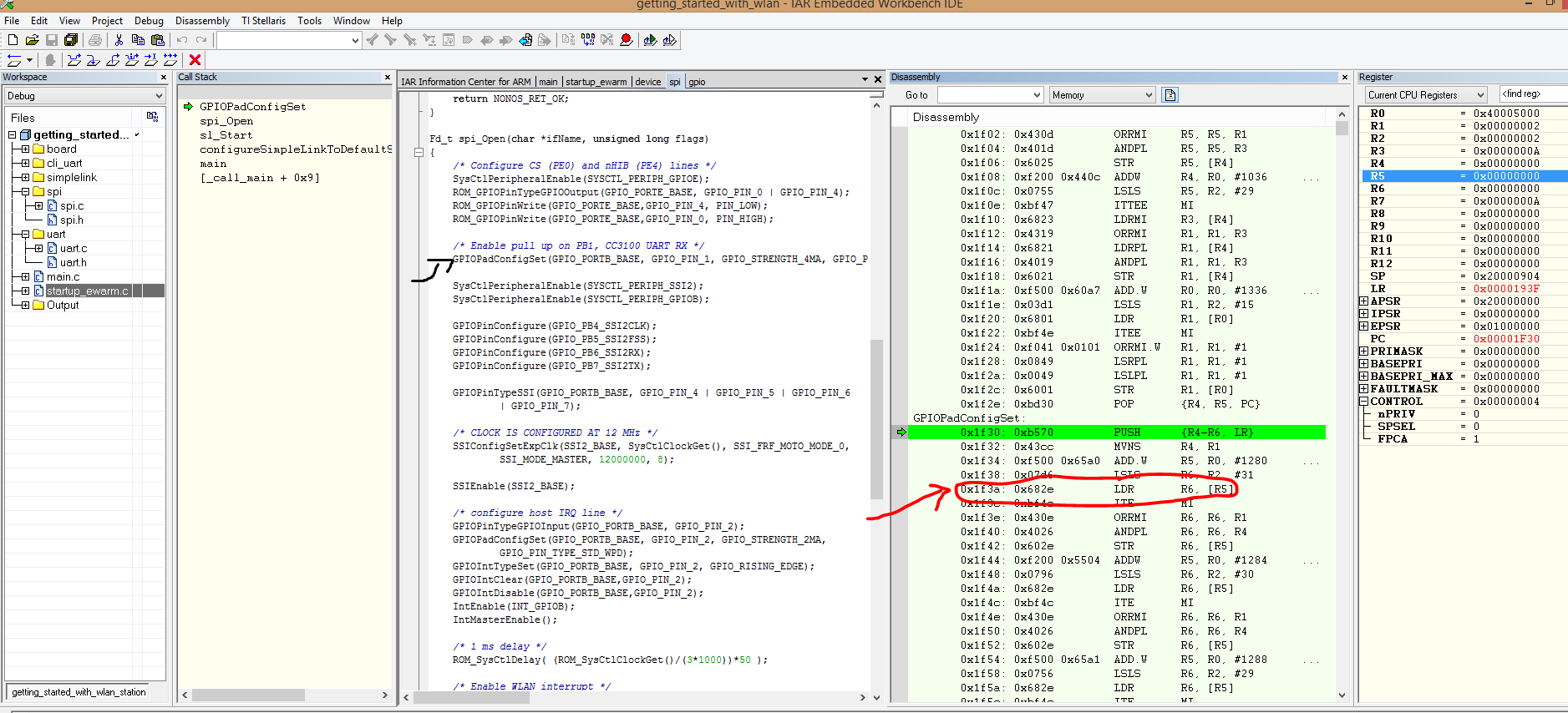

As I run it, although, The code stops at the function showed in the screenshot attached to the post entering the FaultISR function.
I already checked on the site and this kind of problem seems quite common, and as proposed I tried to increase stack's dimension, check correctness of GPIO settings, etc... and all seems correct.
Has someone already used this program? Are you capable of giving some advices?
P.S. I have attached the zipped project
Greetings
