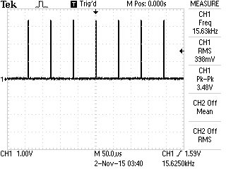

Hi, i need to sample the ADC in a TM4C123GH6PM, the clock is 80 Mhz. The maximum sampling rate that achievement is 15650 Hz, i can see in the oscilloscope, switching a pin. I using: ROM_ADCHardwareOversampleConfigure(ADC0_BASE, 64); that is correct for 15.6250 kHz, because 1 MHz/64=15625 Hz. But if I use a different multiplier, it does not work the microcontroller, for example: ROM_ADCHardwareOversampleConfigure(ADC0_BASE, 32), not work. Can you helpme, please? I Need sample to maximum speed (1Mhz is great!, but 256 kHz or more is good too, considering that audio cars sampling to 192 khz) for implement a FIR filter. Thanks!
My ISR:

  • I've been there a little research and I found that these two statements are equivalent, correct?
    HWREG(ADC0_BASE + ADC_O_PC) = (ADC_PC_SR_1M);
    ADCClockConfigSet(ADC0_BASE,  ADC_CLOCK_SRC_PLL | ADC_CLOCK_RATE_FULL, 1);
    If i use "ADC_CLOCK_SRC_PIOSC" instead "ADC_CLOCK_SRC_PLL", the sample rate is not exactly 15.6250, its value ranges in 15.5xxx kHz. Perhaps it is because it uses the internal oscillator and no XTAL with PLL?
    but equally I can not sample more than 15,6250 kHz.
    What am I avoiding?

  • When I change the sampling rate to another value other than 64, to program the microcontroller, this does not start, do nothing, do not turn on the LEDs, nothing.
    This is my code:

  • Hi, that is strange, if i exchange the order of peripheral initialization, let me more adc sample ratio. SSI->ADC->PWM=>16 (62.5000 kHz), SSI, PWM, ADC =>8 (125.000 kHz) and 4 (250.000 kHz).
    	ROM_SSI_Init();
    	ROM_PWM_Init();
    	ROM_ADC_Init();
    But equally I can not sample more than 250.000 kHz.
    Why, Mr. Anderson? Why, why? Why this occurs?
  • Hello Fernando,
    It seems that the ADC Speed setting in System Control space is getting modified due to the access order.
    Amit

  • Hello Fernando,
    TM4C123 has a common register for configuration of speeds for different peripherals. This did complicate the functions and on TM4C129 the configuration of speeds was moved under peripheral address space.
    Amit

  • Hello Fernando,
    Though I would need to investigate the APIs for TM4C123, but from an explanation perspective assume that the register settings which are common for two peripherals P1 and P2 are in register R and the Set Speed functions are written as
    P1SetSpeed{
    R = P1FeatureBit
    P2SetSpeed{
    R |= P2FeatureBit
    So a call of P1 followed by P2 will lead to a correct setting of R and not vice-versa.
    Amit
