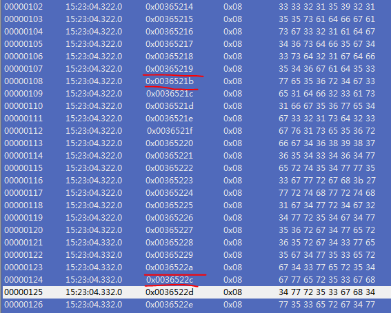

TMS570LS3137 DCAN transmit pkt drop frame
Now I debug the 570 DCAN module. I am using the can bus to transmit pkt, using another USB-CAN to inspect the pkt.
My code are following :
    for(i=0;i<ulFrameNum;i++)
        ulMbId = canMESSAGE_BOX18+i%(canMESSAGE_BOX32-canMESSAGE_BOX17);
        while(canIsTxMessagePending(pCanReg, ulMbId)) /* check the message object tx finished  */
        if(i>0)
            ulLstMbId = (i+15-1)%15+18;
            while(canIsTxMessagePending(pCanReg, ulLstMbId))  /* check last MB tx finished */
                g_ulDelayCnt[i]++;
        if(i==ulFrameNum-1) /* last frame */
            unMsgId.tCANMsgID.ulSegFlag = CAN_DATA_SEG_LAST;
            g_stCanMsgObj[ulMbId].ui32MsgLen = ulLen%8?(ulLen%8):8;
        else /* middle frame */
            unMsgId.tCANMsgID.ulSegFlag = CAN_DATA_SEG_MID;
            g_stCanMsgObj[ulMbId].ui32MsgLen = 8;
        unMsgId.tCANMsgID.ulFrameId = i;
        unMsgId.tCANMsgID.ulFrameTtlNum= ulFrameNum;
        g_stCanMsgObj[ulMbId].ui32MsgID = unMsgId.ulMsgId;
        g_stCanMsgObj[ulMbId].pui8MsgData = pucDataTmp+i*8;
        CANMessageSet(pCanReg, ulMbId, &(g_stCanMsgObj[ulMbId]), MSG_OBJ_TYPE_TX);

when I send pkt about 80 frames, there are 2 or 3 frames droped, the frame no droped was the same every time . Pls help me why this happened.
