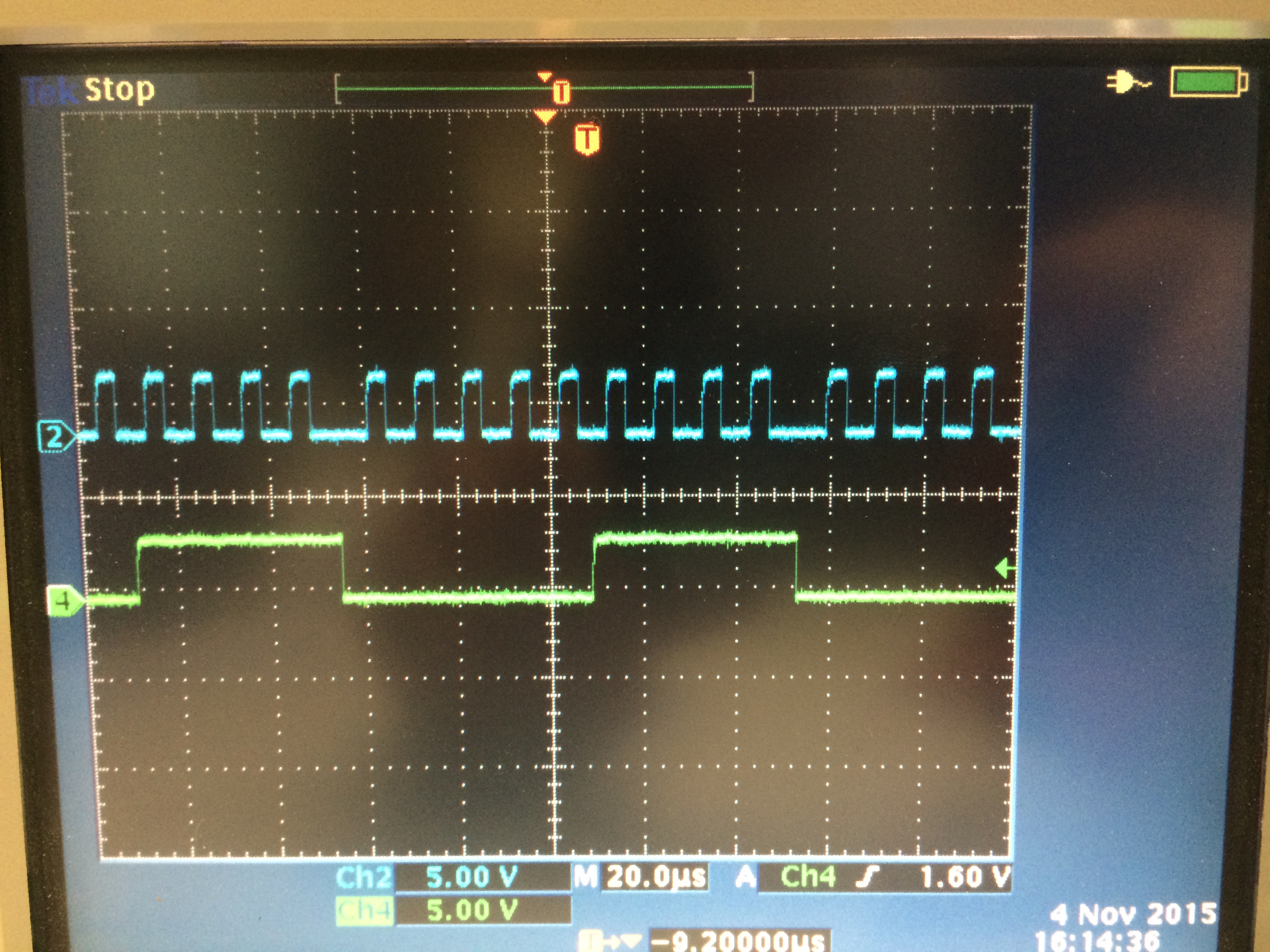

I have got my head around the infrared temperature sensor MLX90614, but have a hard time interfacing it to my TIVA TM4C1294XL microcontroller.
I was previously looking through following forum section, but did not find an answer:
And therefore I am writing here. I am setting up the microcontroller as following:

The issue is, that the return value ALWAYS is 0xFFFF and that was mentioned as well to be a possible error in the other forum post. He did however not tell the working code, and I am suspecting what he changed to make it work.
Does anyone have an idea what might be wrong / lacking here?
I also read from the other article, that it might help lowering the clock frequency. Can it be, that the clock can be set at 16 MHz for the TIVA TM4C1294XL? Or just 40 Mhz? Because I tried that, without working.
