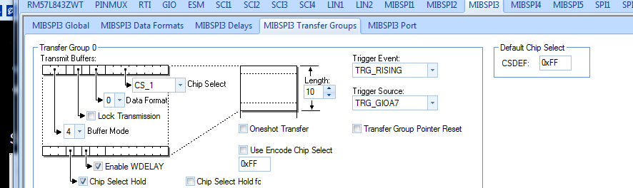

Got a RM57L Hercules launchpad connected to a Seiko/EPSON IMU M-G350 via the MIBSPI3 port.
The plan is to read 500 16bit-words at a time from the IMU using DMA.  The mibspi3 element count is 10, frame count is 50.
Mibspi3 is set up to trigger on GIOA7. This works fantastic- logic analyzer show all SPI signals as expected.
My problem is the DMA receive buffer does not get filled, and I'm confused what DMA interrupt routine should be used (dmaBTCAInterrupt or dmaGroupANotification) and how to configure it. Can not find good documentation for the libraries generated by halcogen.
How can I set up mibspi3 using DMA to fill up 2x 500 word buffers (ping pong scheme) and make it jump to an interrupt routine when each buffer is full?
(In my test code below, i'm trying to fill one buffer only)

    There are two things I noticed in the MIBSPI DMA configuration:
    • bufid is set as 499. That is an invalid configuration as the maximum value you can set as BUFID is 127. I believe you need a DMA transfer at the end of every 10 MIBSPI transfers. In that case BUFID should be set as 9.
    • One shot transfer is enabled (Bit 31 in DMACTRL register). Please disable the One-shot transfer so that the transfer size is controlled by the DMA.
    Hope this helps!
    Thanks and Regards,
    Veena
  • Thanks Veena.
    I set D_SIZE=10. Do you have any suggestions how to set up the dmaCTRL to fill 500bytes, then jump to dmaBTCAInterrupt() ?
    Elementcount=10, framecount=50 still doesnt trigger interrupt.
    The TX channel sends the same 10bytes over and over. Should it be set to mode ADDR_FIXED?

    Let me try to understand your problem better.
    Do you want to sent the entire 500 data for every rising edge of GIOA_7? Or do you want to sent 10 data each per GIO trigger?
    Thanks and Regards,
    Veena
  • I'd like to send/receive 10bytes per rising GIO_A7.
  • I got it to work. Thanks Veena.
