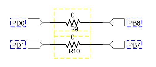

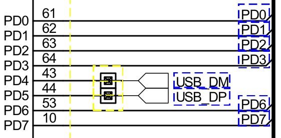

  • Much more basic data is required to truly (and effectively) assist.
    You list your MCU - yet not its carrier. If a LPad - danger lurks on/around PD0 & iirc PD1.    Your job must be to closely review your board's schematic - and actively search for any/all "special connections and/or signal handling!" PD0 - for sure - finds itself directly connected to another MCU pin - that's rarely good - and often very wrong. (and it's your job to discover & deal w/such issues)   Such "interesting" (and destructive) forced connection IS noted upon your LPad schematic!
    I could spend the time/effort to exhaustively review your code - yet how does that improve your skill level? A suggestion to adopt KISS was made - most always this will speed, ease & enhance - both your (and my) troubleshooting efforts. You're silent as to your adoption.
    My preference is for a troubleshooting "collaboration" - not for a "cookbook fix" - which cannot best serve you - now and especially long-term.
  • Hi cb1,
    Yes, I'm moving in the KISS direction - basically simplifying my code backwards until I find what is causing the problem. Then from that point I will build my code back up to the functionality I need.
    There are a few terms in your question I'm not familiar with. What do you mean by carrier? I assume you mean the board that's housing the LCD screen and other external hardware I'm working with. If that's the case, then it is a custom designed board made by another member of my team here.
    Second - what do you mean by LPad? I have the schematic for the dev board I'm using, and it doesn't show anything connected to any of the port D pins I need:
    I definitely agree on the collaboration point - right now I'm just working at getting anything on the display, but once crossing that hurdle will need to do quite a bit more with it so knowing the ins and outs of SSI is critical to me!
    However, your point on the MISO vs MOSI pins was very helpful, and obviously something I had overlooked.
    Now, following your suggestion, I am checking the physical voltages on my board vs the software settings to make sure things line up, and have found an issue with PD7, which I'm using for reset. It seems the board designer included a 10k ohm resistor to ground here, and I have an inkling it doesn't belong, so I'm pursuing that with him.
    However, I find the documentation on SSI to be rather un-helpful for someone, like myself, just starting out with SSI and SPI. The Tiva manual includes a description of all the SSI functions and what they do - but not when or why one should use them. This is why I was wondering if you could look at the the two "critical" functions in my code - to see if there are some simple/beginner mistakes I am making:

  • Sorry - I dislike "free vendor promotion" so LPad means Launchpad - the standard Eval board for your MCU. That board - in (someone's) infinite wisdom - wired 2 sets of MCU pins directly together. (PD0 being one)

    Thanks for the tip on NMI - I found another forum post where you offered steps on how to unlock PD7 and that is now working.
    Also, I think I figured out what you mean about PD0:
    Why is this done, and how do I get around it? Or does this mean that what appears to be four GPIO pins: PD0, PD1, PB6, PB7 is in fact only two: PD0/PB6, PD1,PB7?
    Good that - 101 wrong - 3 right - but (really) who's counting?
    And Eureka - you've found vendors (always) helpful "dead short" between MCU pins.   It's reported that crack decision was made so that past (far lesser) "M0-killer" vendor MCUs could serve here, too.   Yet - that happens rarely - and vendor cannot bring themselves to "Declare Victory" and provide those 2, 0Ω "plague-istors" in a (proper) plastic bag - for those (extreme few) who actually seek (lesser MCU) compatibility!
    You must remove those 2 devils - I suggest that you "tombstone" them - hard to lose and you'll be (always) reminded of vendor's great care/concern.   (alas little of that directed toward you/other board users...)   (tombstone = remove the 0Ω R - and reinstall it vertically (contacting just one pad - thus "out of circuit.")
