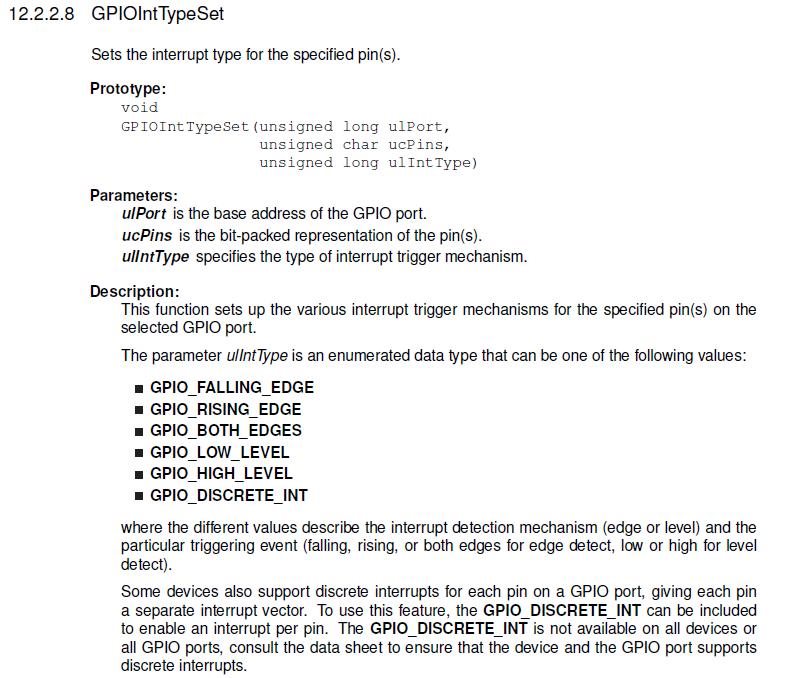

  • Hi, very interesting the post,
    but if I want use only one pin for measure the pulse width?, exist any form to identify wich edge is detected, if positive or negative edge when i am inside the interrupt routine?
    I configure to interrupt over both edges, and i want to identify the responsible edge of interrupt inside of interrupt. How do yoy do this?
    Thanks!

  • Fernando,
    I am not so sure that a PIC maintains a registry to inform that the GPIO transition was rising or lower... Are you sure??? Still, what happens if an opposite transition happened shortly after that one?
    It appears to me that it is more of a software API implementation.
    Anyway, a few engineering options:
    - If your signal is not "too fast", enable the interrupt for both directions, and simply read the GPIO level when servicing the interrupt.
    - If the signal is faster than this can take, use DMA to transfer the GPIO level at the moment of interrupt to a storage location...
    - Or use the brillilant/simple cb1 solution: split the signal into two TCCP pins, and configure one for rising transition and the other for lowering.

  • Thanks, I have been looking at some register of the TM4C123GH6PM if you can know because of which flank the interruption was due, but I did not find anything. Greetings again and thank you very much.
    Fernando.
  • My friend - it would appear your "Search Tactics" may require (some) revision.
    You will immensely aid your efforts by finding, then reading, understanding & complying with the simply terrific GUIDANCE provided w/in the, "SW-DRL-UG" (User's Guide for the Peripheral Driver Library).   (name may have changed - yet this gets you "close.")
    If I may - I import from that very document - GPIO Chapter - focused upon Interrupts:
    Again - avoid the use of "JUST ONE" pin - instead - get your TWO PIN method to work!   Only then - invite "Pain/Suffering" to your table - in the attempt to "Save ONE Pin."
