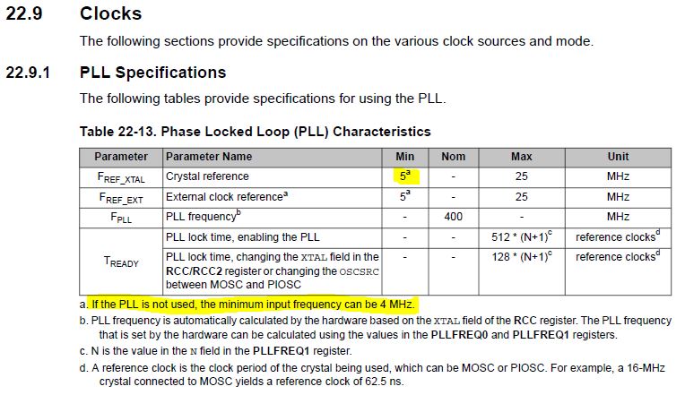

  • Upon my 2nd read of your post I noted TM4C1294XL.    My cut/paste (below) is from TM4C123xx - but may suggest (where) you should search to find similar for your MCU.   (data I've provided springs from the rear of the MCU Manual (cheap-seats))
    Several "gotchas" w/in this data:
    • should you employ the ADC - the MCU's system clock must be 16MHz, minimum
    • w/out engaging the PLL this chart specs 4MHz as minimum system clock - many code examples illustrate system clock setting w/out the PLL
    • suspect that to reduce system clock (to lowest) you must employ a 4 or 5MHz external xtal and NOT enable the PLL.   Your board likely includes a higher frequency xtal - and that is likely to limit the lowest system clock you can achieve
    • this data may have changed for your MCU - you must check
    • it is possible to run from the low-frequency (~32KHz) internal clock.   Code execution will be drastically slowed - yet power draw is much reduced.
    You've not explained your desire for, "minimal system clock speed."   Should "power consumption" be your driving issue - there are multiple, other methods to reduce such - and avoid so drastic a slowing of code execution...

    To add to what cb1 has mentioned, lowering of the system clock can be done upto VCO of 480MHz divided by the maximum PSYSDIV value of 1024. This would be ~468KHz. However at such low system frequency, peripjherals like ADC, USB and Ethenrent would not work. Also a lot of other peripherals like I2C and UART would also not be functionally possible.
